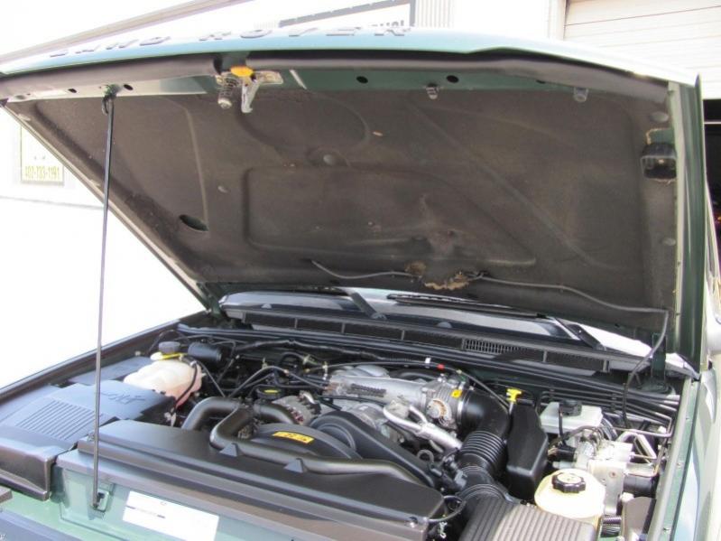

Oh man. I was so excited about getting a newer Discovery. I was just looking at this one on EBay. The picture shows a rip and maybe signs of a blow up in the hood liner. I am sure some of you Rover detectives could tell me if is this from the oil pump blow up? or something else. I hope the picture loads up
