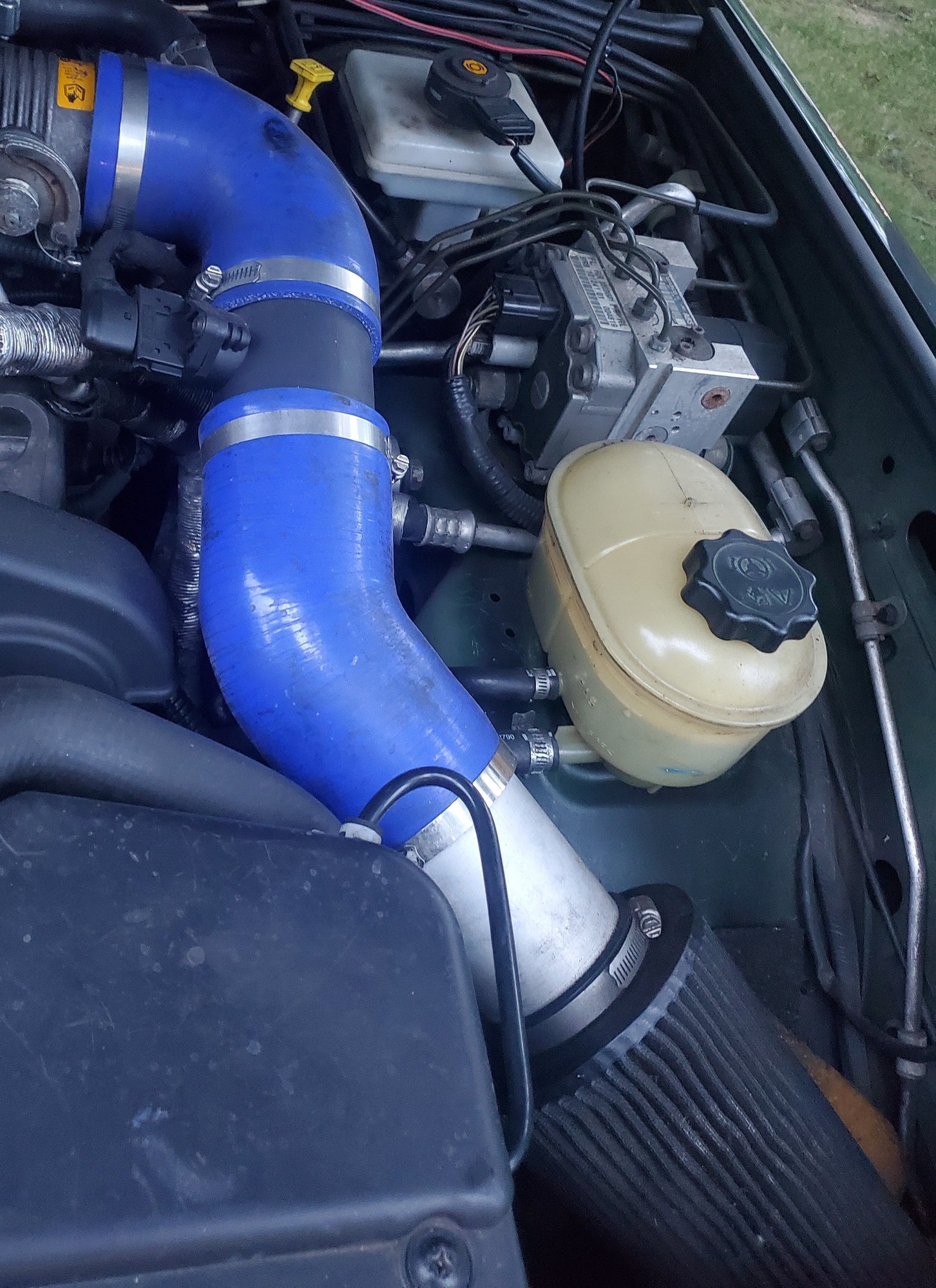

Default This is my set up.
if you rotate the elbow to where the air filter sits near the body, then make the hole for the iac valve so that the small black 90 hose sits square. That would address the height of the filter. I siliconed the nipple into the elbow. You cant really see it is behind the elbow.
