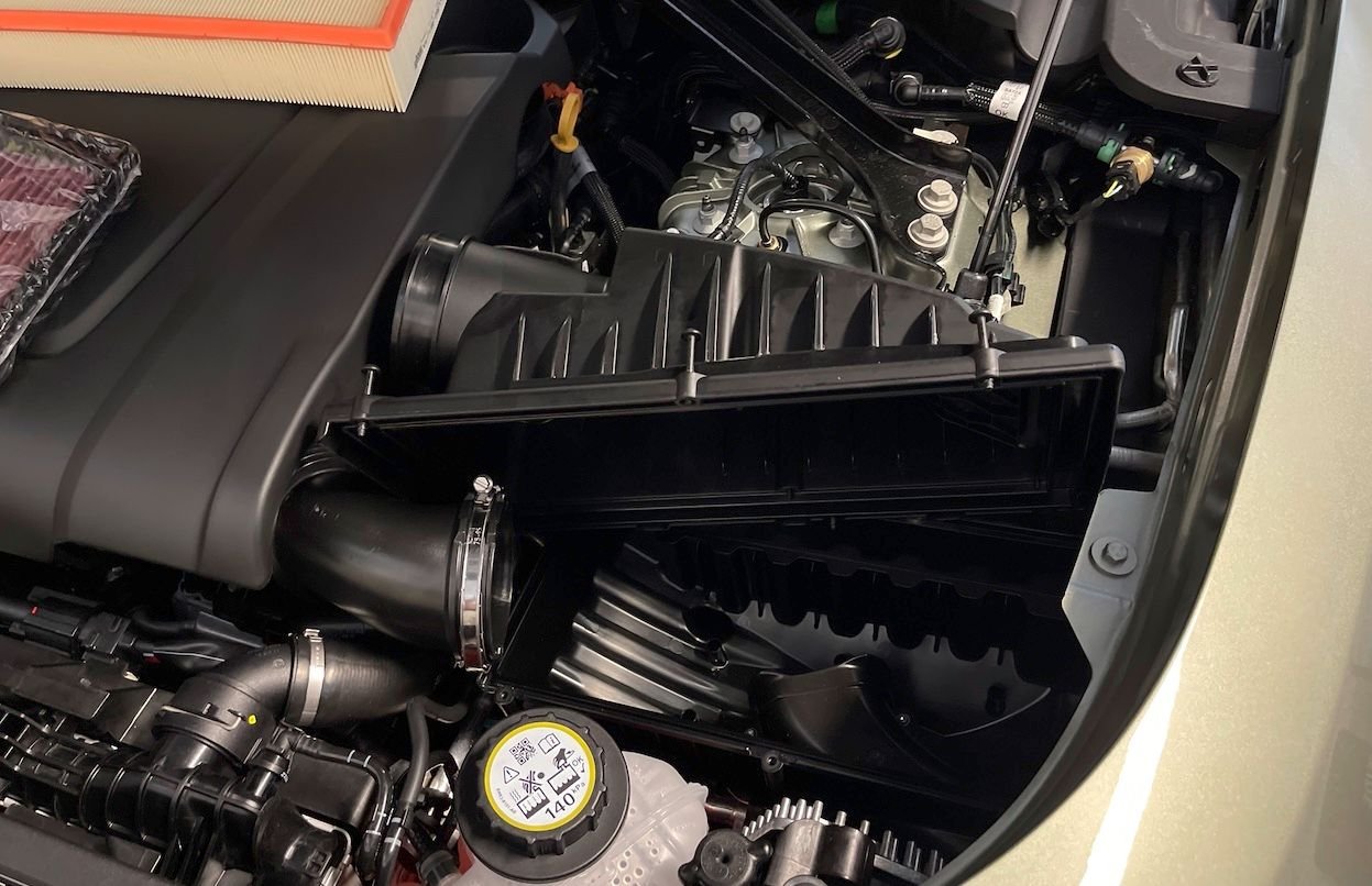

The filter is the same for the 6 and 4 cylinder.
Part #33-5093
I have the p300, so I probably have a bit more engine bay room.
Replacing the air filter was the most pain in the butt I have ever experienced.
You'll need a flat head screwdriver and a T-25 Torx screwdriver.
There are 6 Torx screws, 2 of which are difficult to get to.
Loosen the screws, until they are almost out, you do not have to fully remove the screws.
Loosen the clamp that connects the air box to air hose that goes to the engine.
Disconnect air hose from the air filter box.
Remove the air filter box top.
Replace air filter and follow the instructions in reverse.
