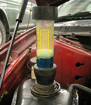

Yes, replace with same style shaft with grease fittings on every joint. Dealer maintained means by dealer schedule, so cooling system has likely never been flushed. Take your scanner to look at codes and coolant temps, etc. Even spring for one of those exhaust gas in coolant tests. Or even better, pay an indy Rover mechanic to exam it; he does not have the hots for a new ride, and may well find things you would miss. Get it warmed up enough for "the tick" to appear.
