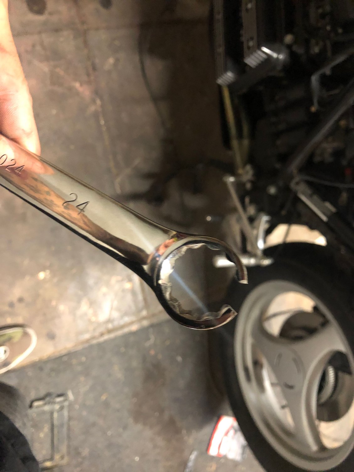

Just got this all cleared up. Hardest thing is that without riveting the base plate you can't get full pull on the lever.
I gave a good look at my cable mount and noticed the original threading had some shine to it, so it needed to be seated further.
Had to hack up a 24mm wrench to go over the cable.
To fix:
The baseplate of the shifter will need to be removed, but if you've replaced your transfer case this is a needed step anyway.
- Loosen the nut in the back, notice where there is shine in the picture below
- Tighten the nut closest the engine
- Keep testing until the CDL light goes off on the dash
- Transfer case cable on top of transfer case
- 24mm open ended wrench
- Tighten both nuts
Hope this helps someone in the future.
To fix:
- Tighten both nuts
Quick Update:
The above fix got me into Hi and Lo, which was also an issue.
Below fixes the CDL light on the dash, so you can seat the lever appropriately...
I had to re-adjust the diff lock cable above the front driveshaft and test/retest that it was seating properly.
(Uses the same open ended 24mm)
Now Hi/Lo and Diff lock/Un Lock work properly and turn the CDL light on and off..
Whew!
Now I can put everything together.... hope I helped one person
Whew!
