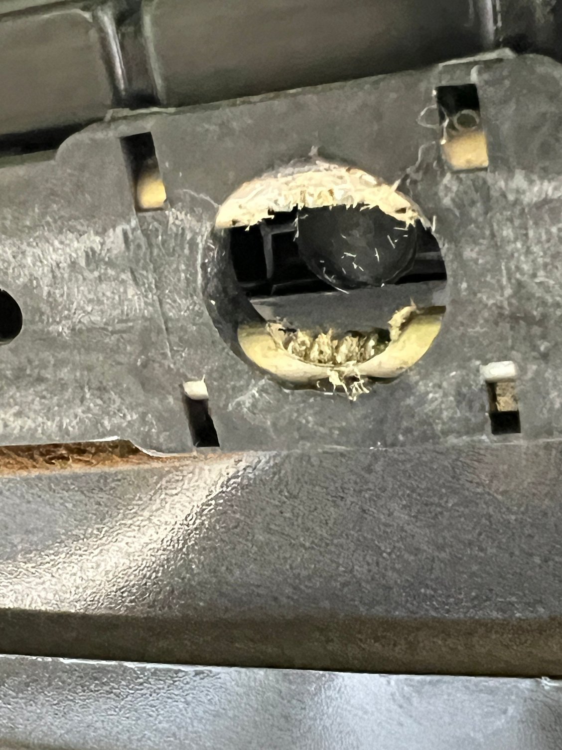

2. I noticed lots of grime with what looks like hairs in the exposed gears that fits into cable assembly. Also same stuff at the cables. Does this all need to be cleaned out or is it some sort of lubricant? (pic attached)

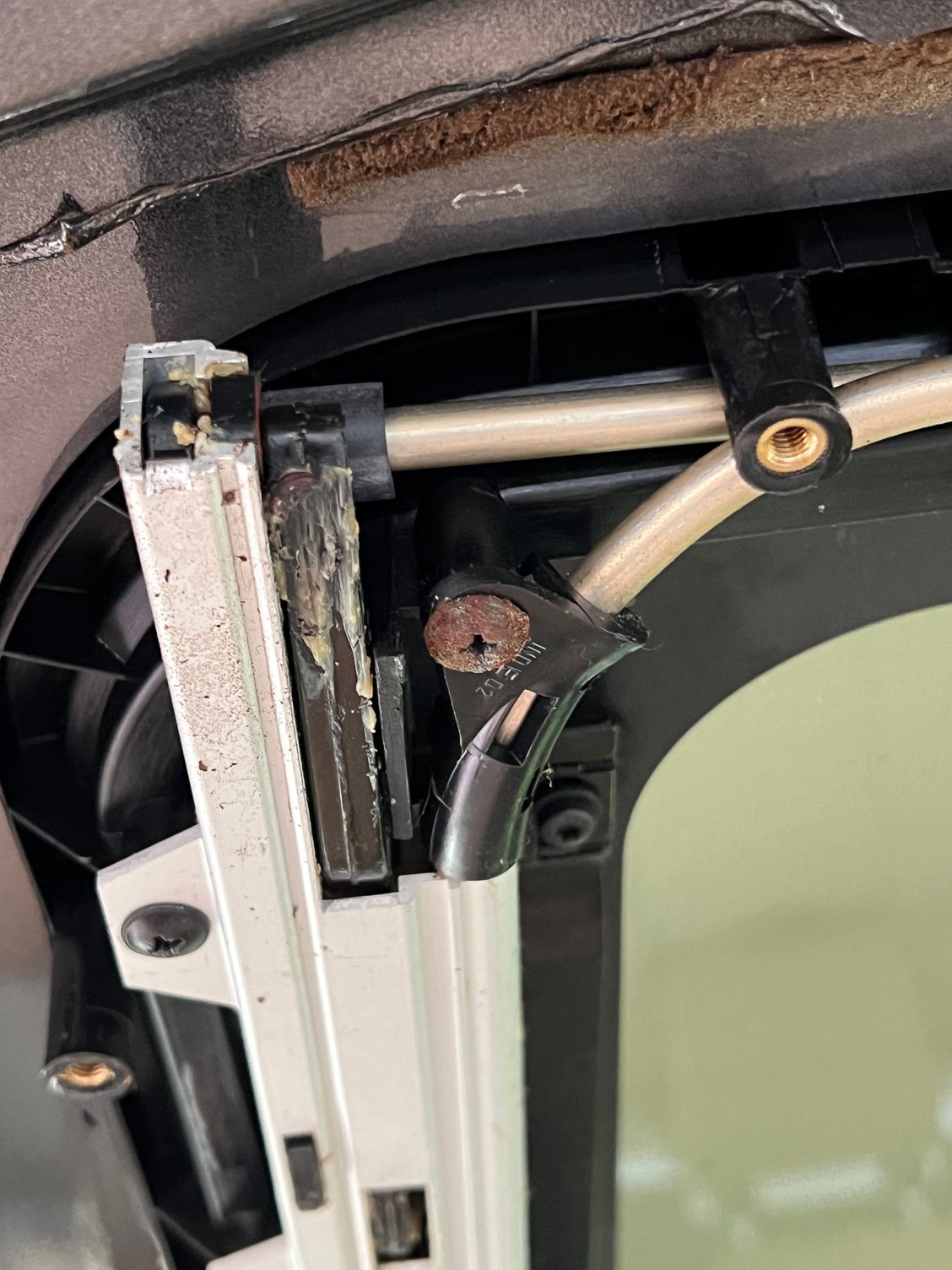

3. Only found one rusty screw on the front sunroof track. Will be replacing glass rubber seals when they arrive. Do you also re-grease the arm joints that move the glass? (pic attached)
Never see that before, is it greasy? Might be good to clean it. If you remove the actuator tubes and tracks you can figure out how to disassemble the actuators from the cables and remove the cables for cleaning.
Yes, I use Maxima chain was because it goes on line a spray penetrant and then dries completely tack free so it does not attract dirt or debris.
Originally Posted by dsprad9
4. I purchased Sikaflex 291 marine urethane sealant for sunroof to frame replacement. Seems like everyone uses something different so I'm assuming this will work as well?
Yes

That stuff in cables kind of looks like PTFE pipe thread sealant. Working on the pans this week. Will get to the glass/frame after that and maybe I'll figure out more.
