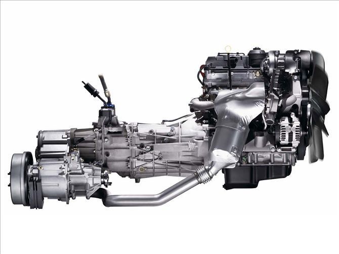

To OP,
what about
>Ford plant like duratorq
>getrag MT82
>LT230 adapter
>LT230
>DC shafts
Final production setup for the defender was the ford Tdci and MT82, what is nice is they already make the adapter for the MT82 output to LT230 input, ashcroft even makes an improved version. MT82 would also be able to mate to a variety of motors, like the ecoboost also?
One issue however is prop shaft lengths and the LT230 is angled to mate correctly with the getrag trans, so double cardan shafts a plus.
