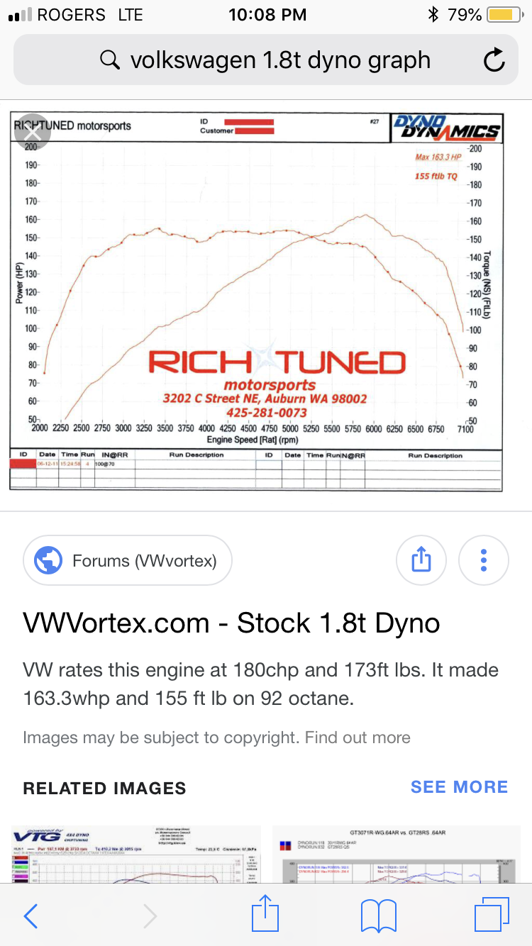

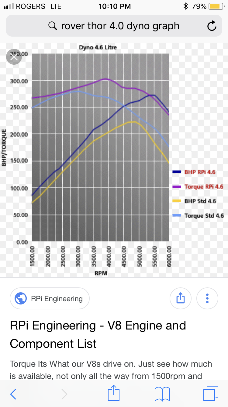

For ****s and giggles I found dump graphs for the stock 4.6 and that 1.8t. Wanted to see how they compare and at what rpm’s. if your towing a trans with a lower first gear would be better for starting out.
Or a transfer case with a higher high range ratio would help too. You could also ditch the stock transfer case and pull a whole setup out of another truck from a scrap yard. I’ve done quite a number of engine/ driveline swaps in the past. All fun to do and even better to drive afterwards. Most rewarding one was a 5.0l roller cam motor I converted to carb and installed in a bronco2 with a c4 tranny. Lots of custom work. Made all adapters myself. Second was a 460 into an f150,
