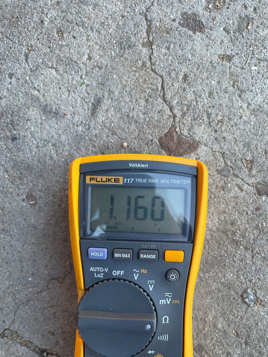

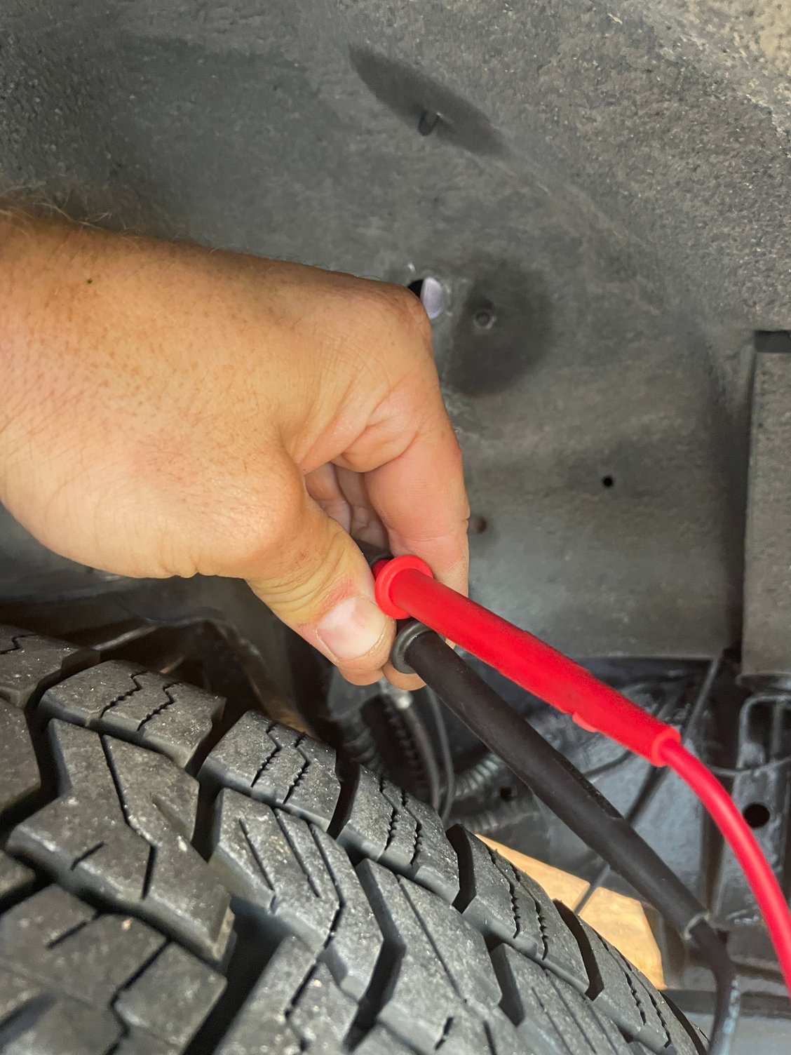

9th replacement hub in a year. Again, put this one on and pop, 3 amigos. I’m just curious how these China hubs can continuously be so terrible. These ohm values indicated a bad abs sensor wire, right?

If I remember correctly 950 - 1100 ohms is good.

Yep, 950- 1100 ohms is the correct range. Bottom of p.877 in my copy of the RAVE PDF.
I don't know why a new sensor would read high like that. It likely won't help, but I'd read the resistance at the SLABS connector, not at the sensor. The reading at the SLABS connector is what matters.
But dude, 9 hubs in a year? What's goin' on?
