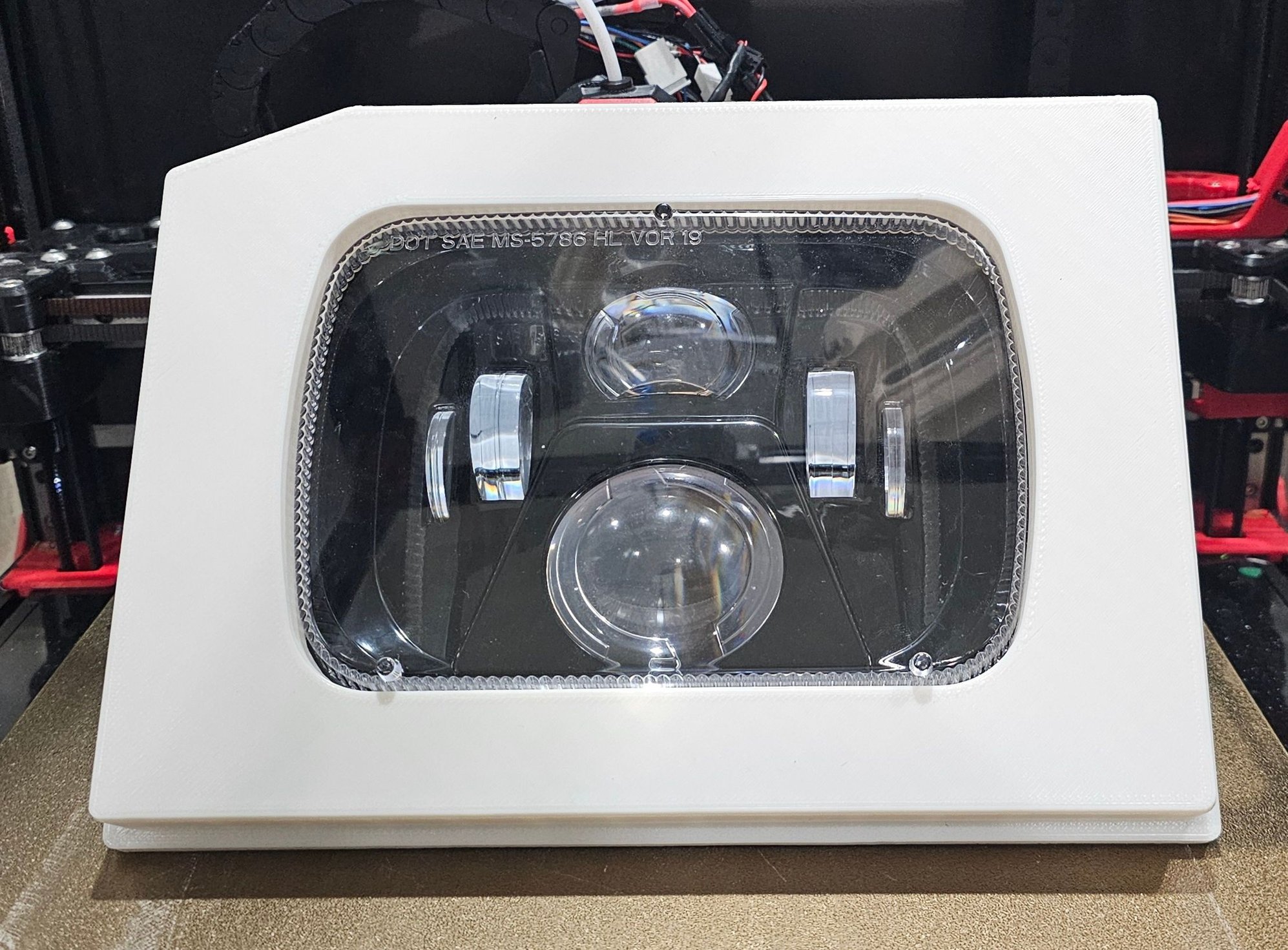

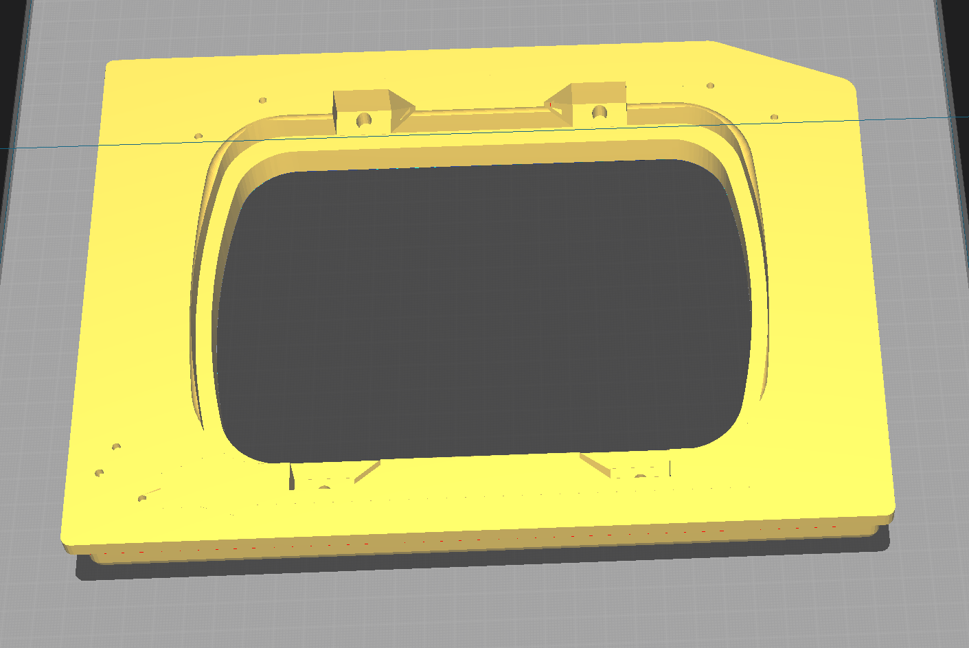

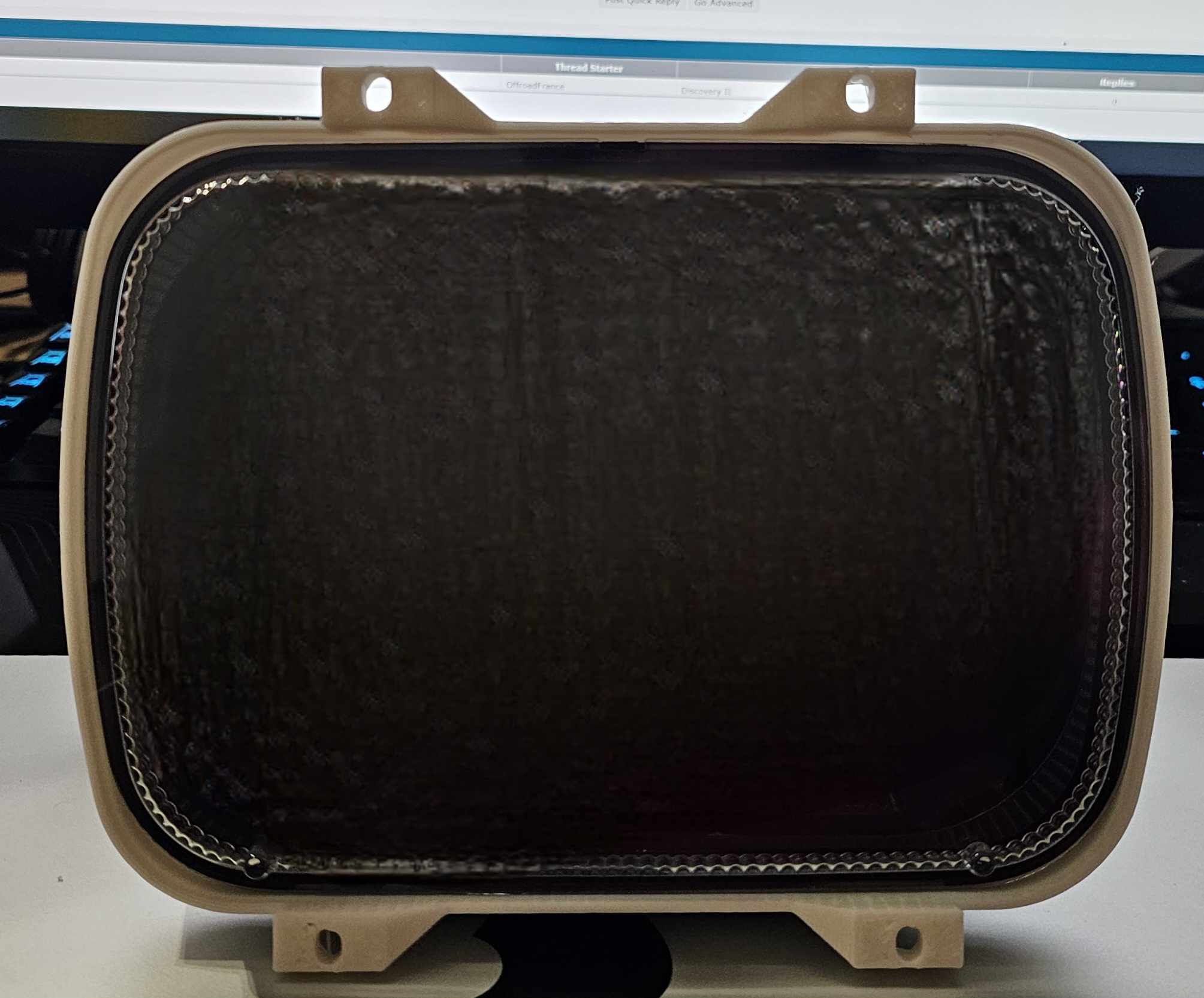

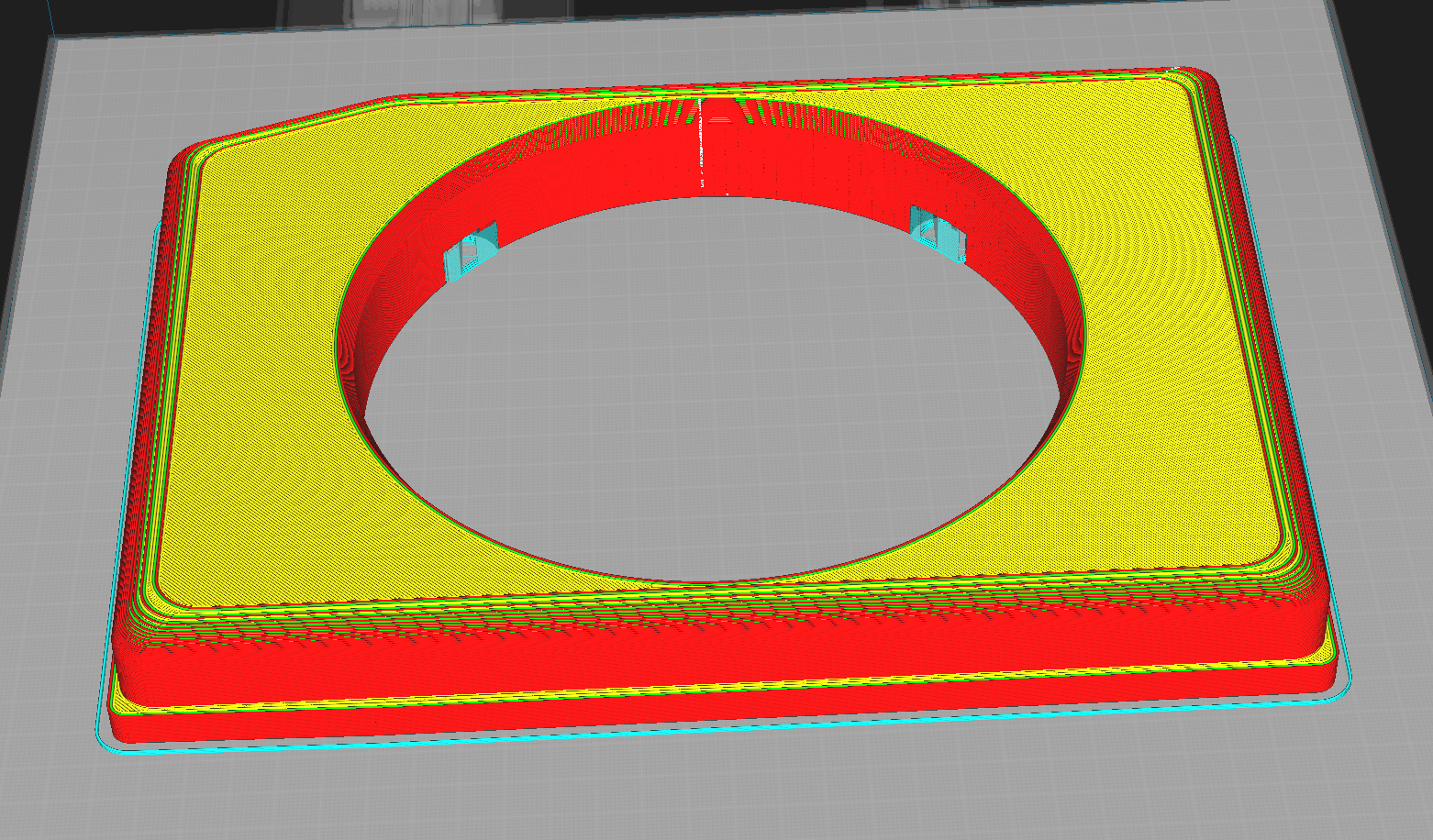

Not that i am aware, i found it on etsy and bought a pair, but kinda seems scamish since the person didnt know what came with the kit- they did have the layouts on there.
I had someone make the model, then i modified it to the 5x7 and an actual bracket system for the light.
Its printing now, and ill edit the pieces till they work- then break out an ASA or PC roll for final production.
Attached Thumbnails 3D Printable Parts Collection-screenshot-2024-01-17-222614.png   3D Printable Parts Collection-screenshot-2024-01-18-004300.png   3D Printable Parts Collection-screenshot-2024-01-18-004416.png

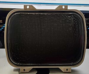

Part 1 down
Attached Thumbnails 3D Printable Parts Collection-414983000_1295828098485861_3740364531493041665_n.jpg

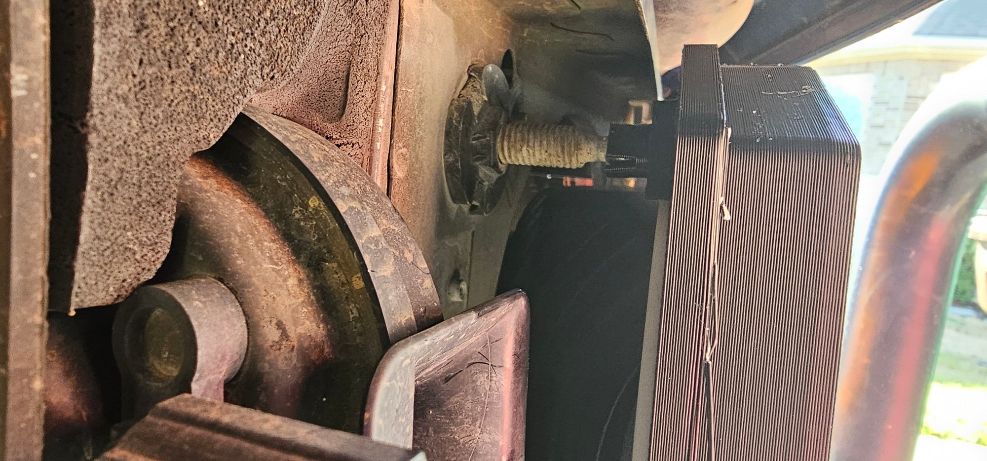

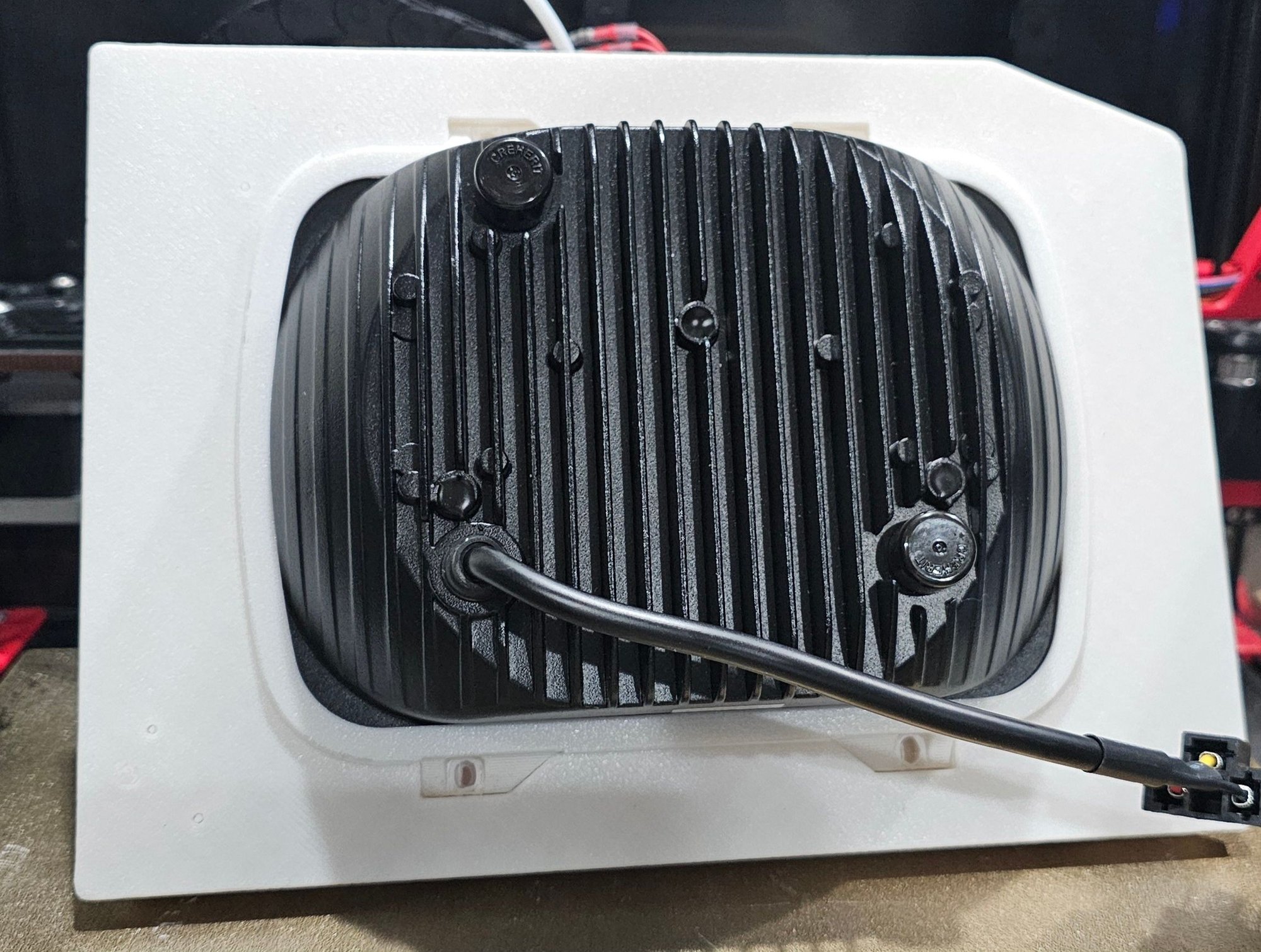

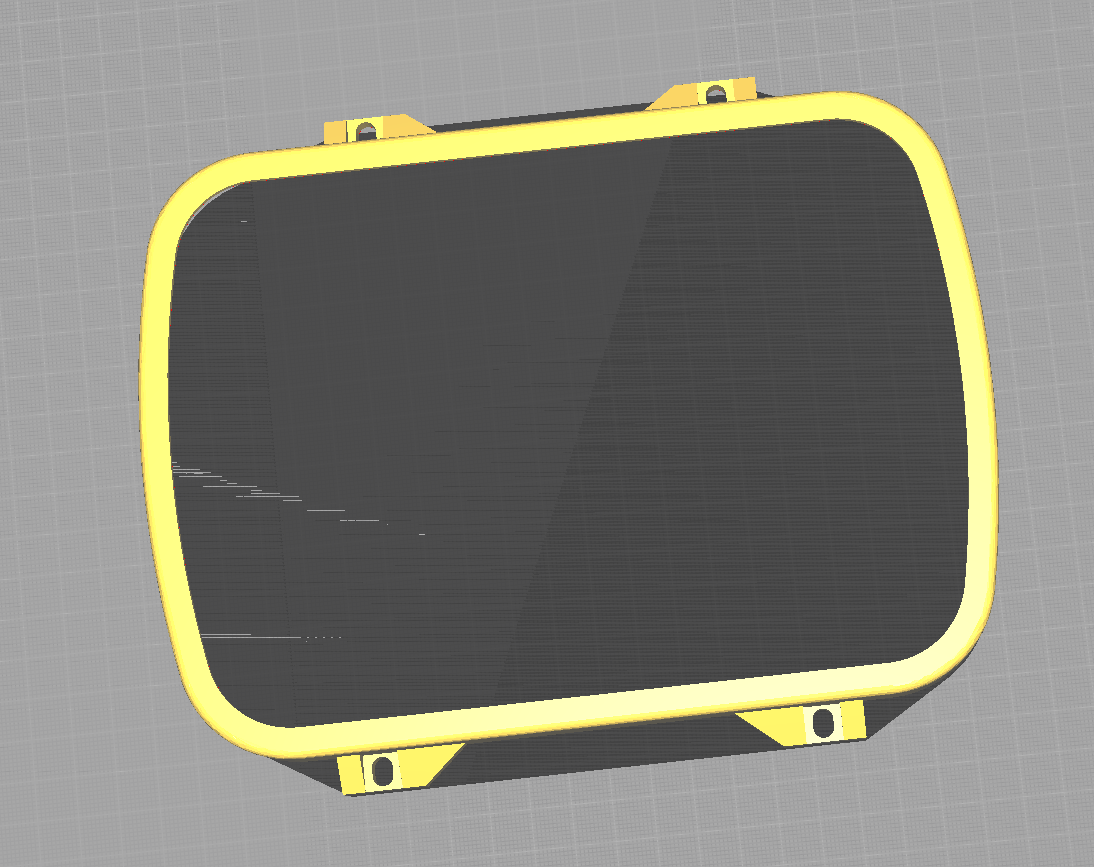

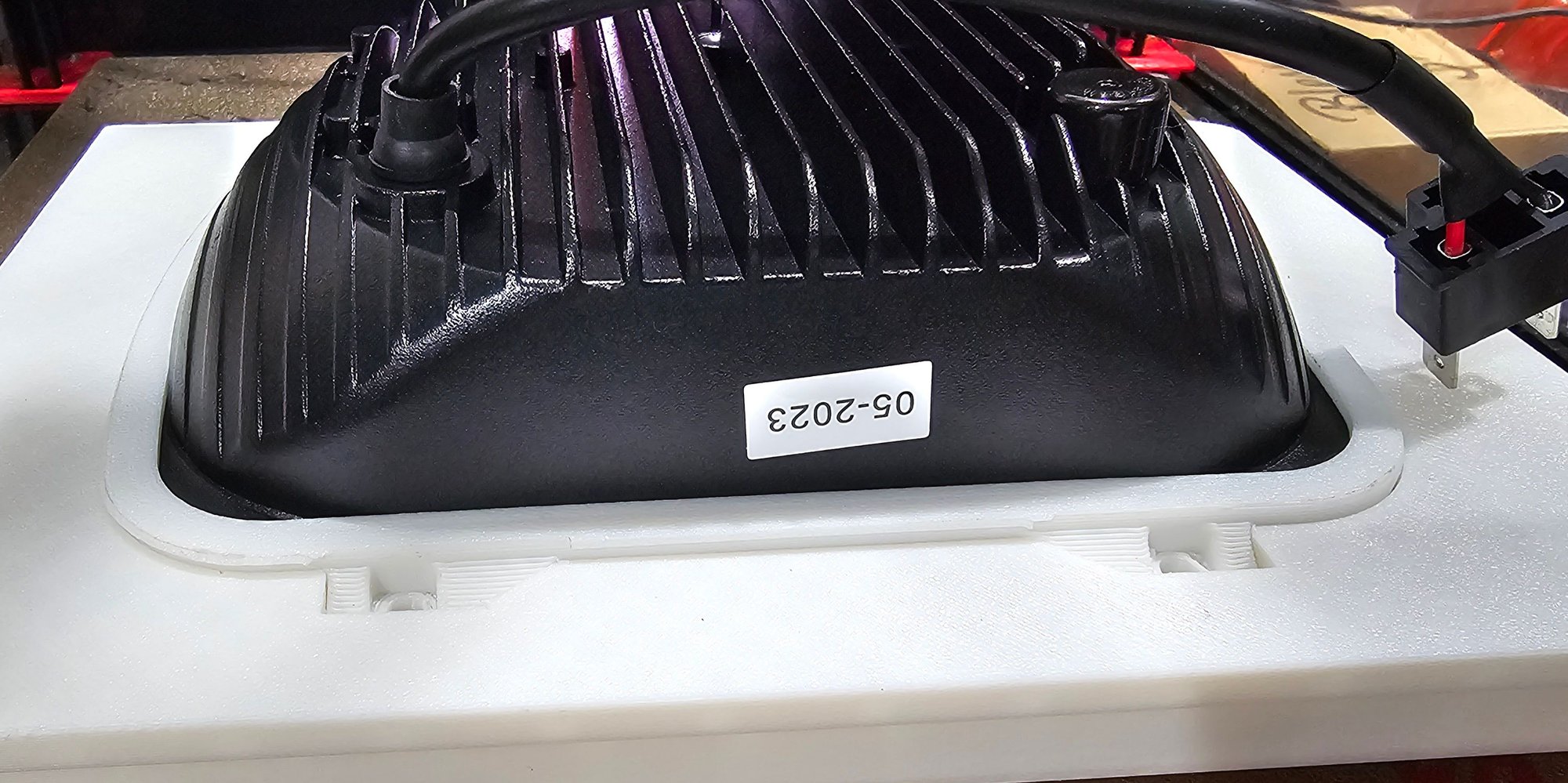

Version one had issues with fitment of the light and the bracket was not tight on the light.
Version 2 fixed the fitment issues and the new bracket is perfect.
I will work on mounts for version 3 once i get spacing re done.
Version one test fit
V1 testfit
Ver 2 fits better
Rear bracket redesigned as well
Holds part tight

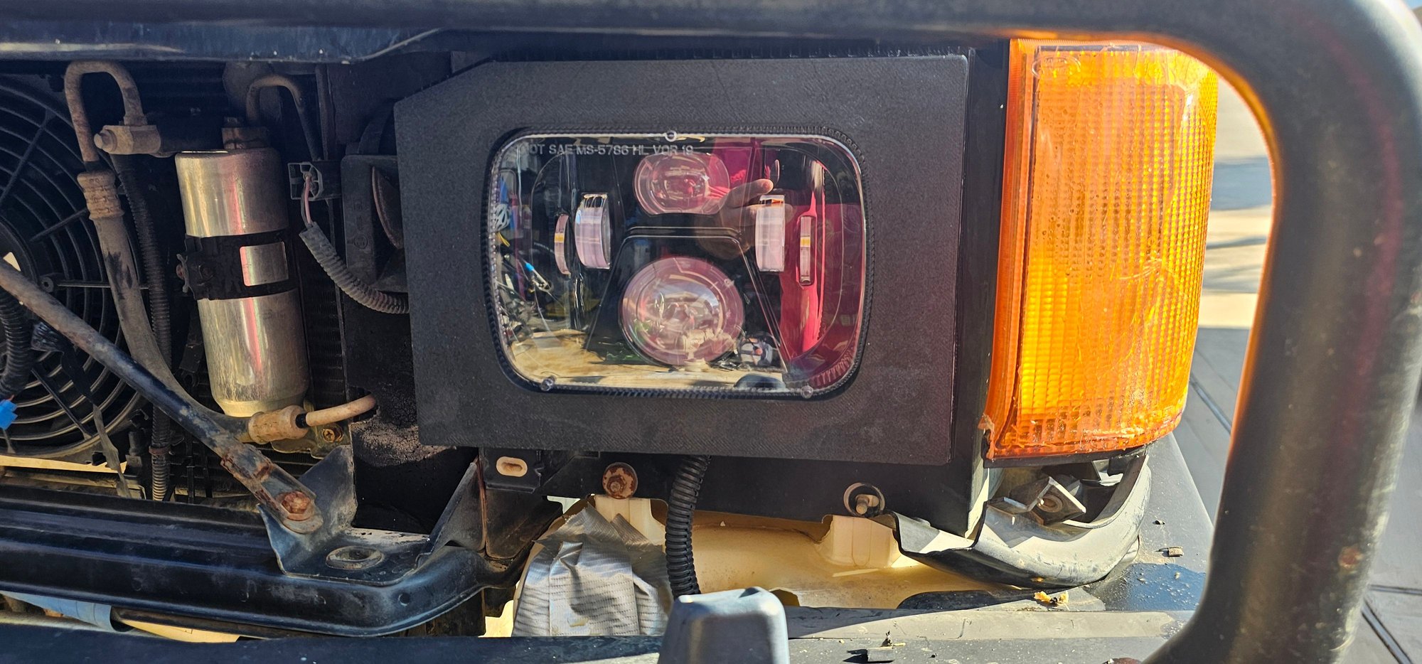

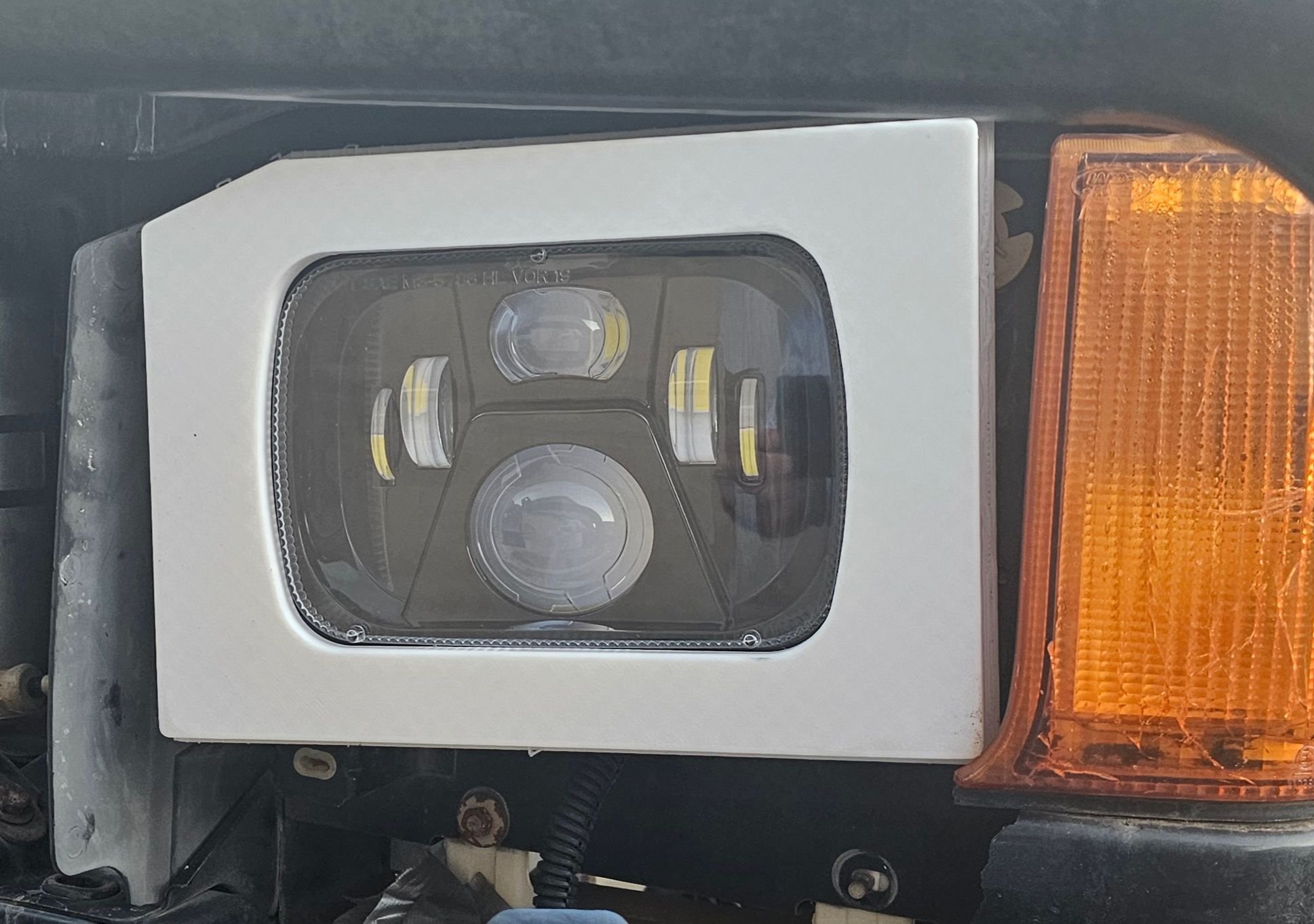

Drying asa now, was able to make a bracket template
Had to cut the turn signal but my was broken anyway.
Night testing soon!
