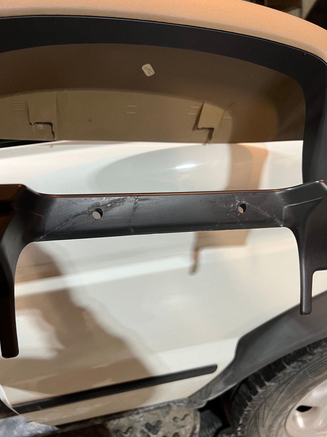

I was thinking about asking my son if he could even design/print some replacement clips for the front portion. It's his vehicle that we're fixing up, so he may be motivated to do it.
Clip/sand the old ones off and use adhesive to attach new ones...
Picture below from the web, ours are tan, and both snapped.

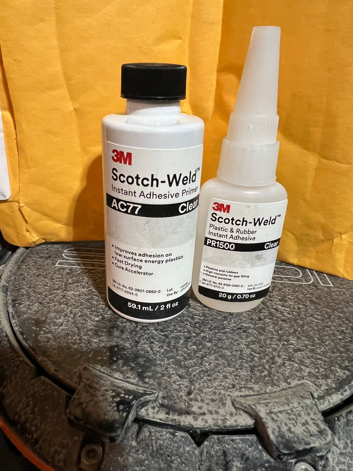

I used some 3m specialty adhesive to glue together the broken bits at the front where it attaches with two screws. It isn't beautiful, but it works until we can find an affordable replacement option.
