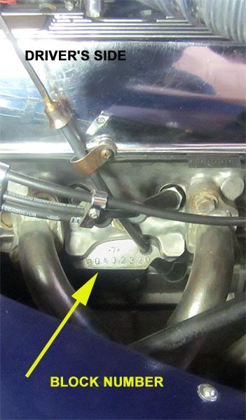

The serial number of the block is located where the oil dip stick enters.

If they had changed the engine to a different size, they should have also changed to the correct ECU and fuel pump to match. I purchased a 2004 (4.6) that the previous owner swapped in a good 4.0 block and internals, but used the 4.6 heads, injectors, ecu, and fuel pump. It ran like cr@p until my mechanic figured it out.
The engine number is on the drivers side by the dip stick. Use this chart to identify which engine it is.
https://rimmerbros.com/c/Rover-V8-Engine-Numbers
