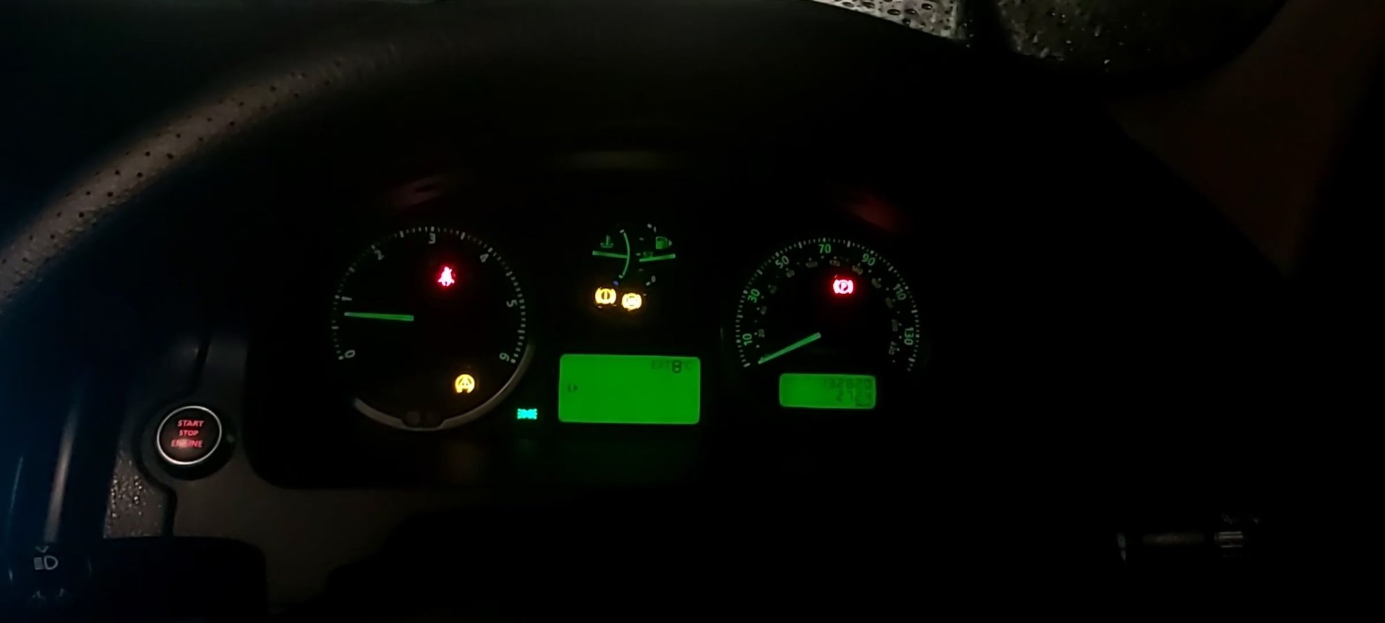

I have a freelander 2 td4 gs 2009 and this is what I found
when driving on very wet roads suddenly I would feel like a sudden breaking then the 3 amigos make there appearance on my dash. The car would still run ok but didn't know what was making them come on
I began to use my OBD2 tester but needed the 3 amigos to come up first before the code appeared as every time the engine switched off and the cables dried the 3 amigos would disappear

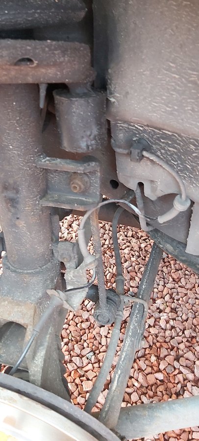

Once this happened I found what wheel i needed to check from the error code and it was as simple as the pics below show
just a exposed cable that had fallen out of its grommet holder and was rubbing.
The 3 amigos on my dash.
Rear wheel, drivers side abs sensor cable
Close up of the damage that brings up the 3 amigos when wet
all I did was a bodge job but I got some weather proof electrical tape, made sure the cable was dry and wrapped the damaged part of the cable
No more 3 amigos, and car all good, I may need to replace the sensor at some point but for now there is no problem
