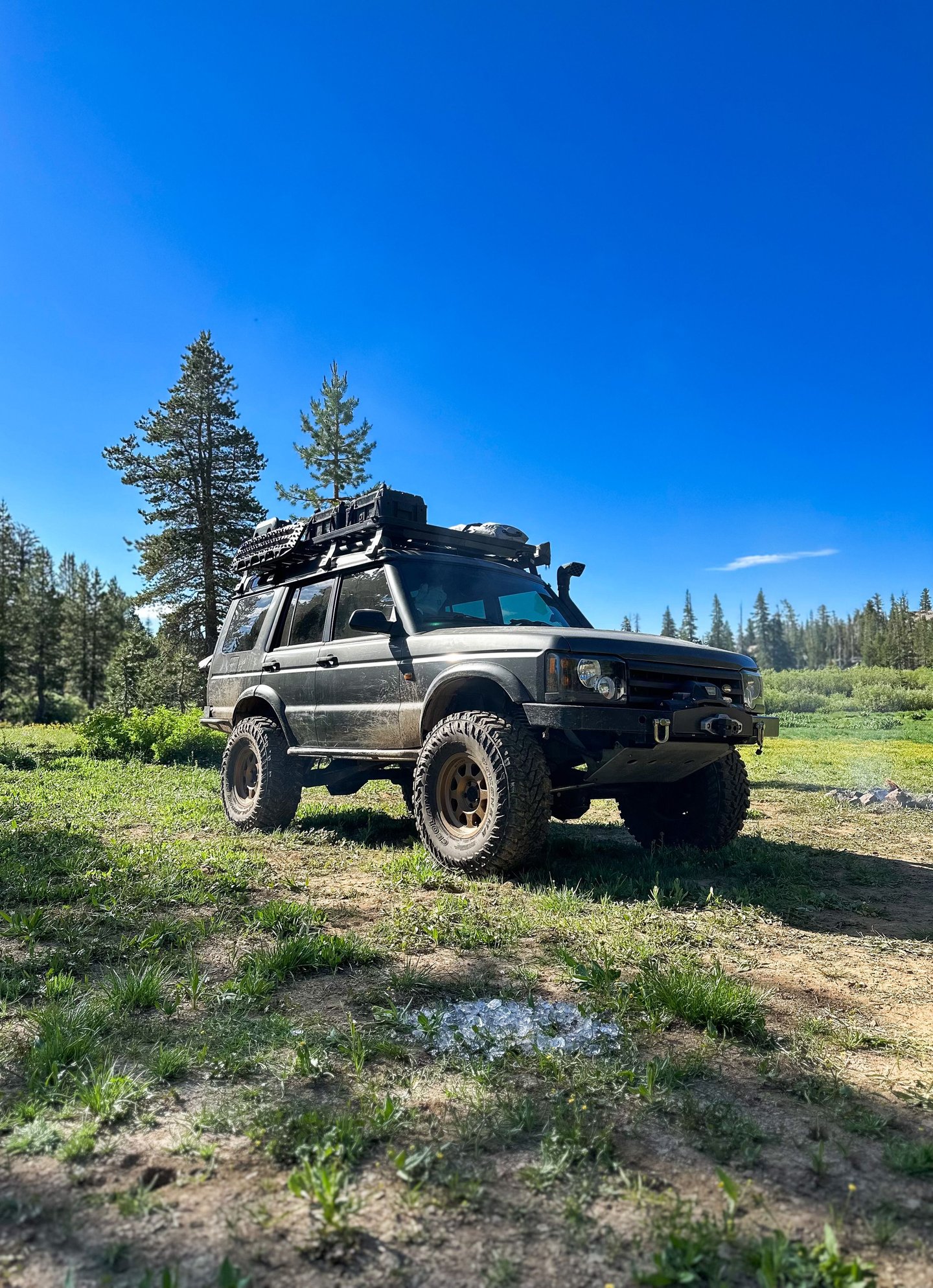

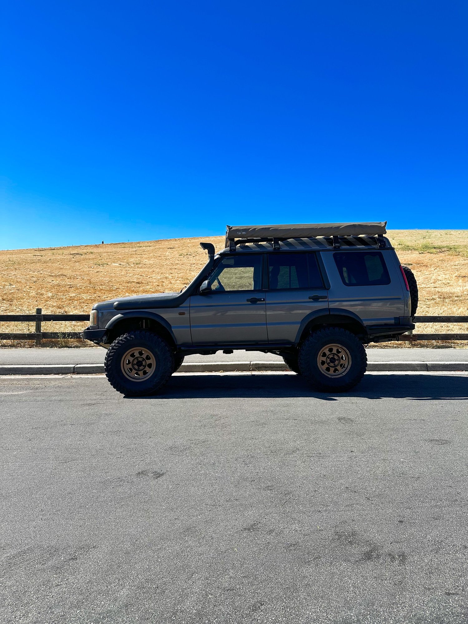

Bilstein 7100 from GBR on my 4.5 in RTE lift. First pic is fully loaded with gear and second pic is unloaded.
