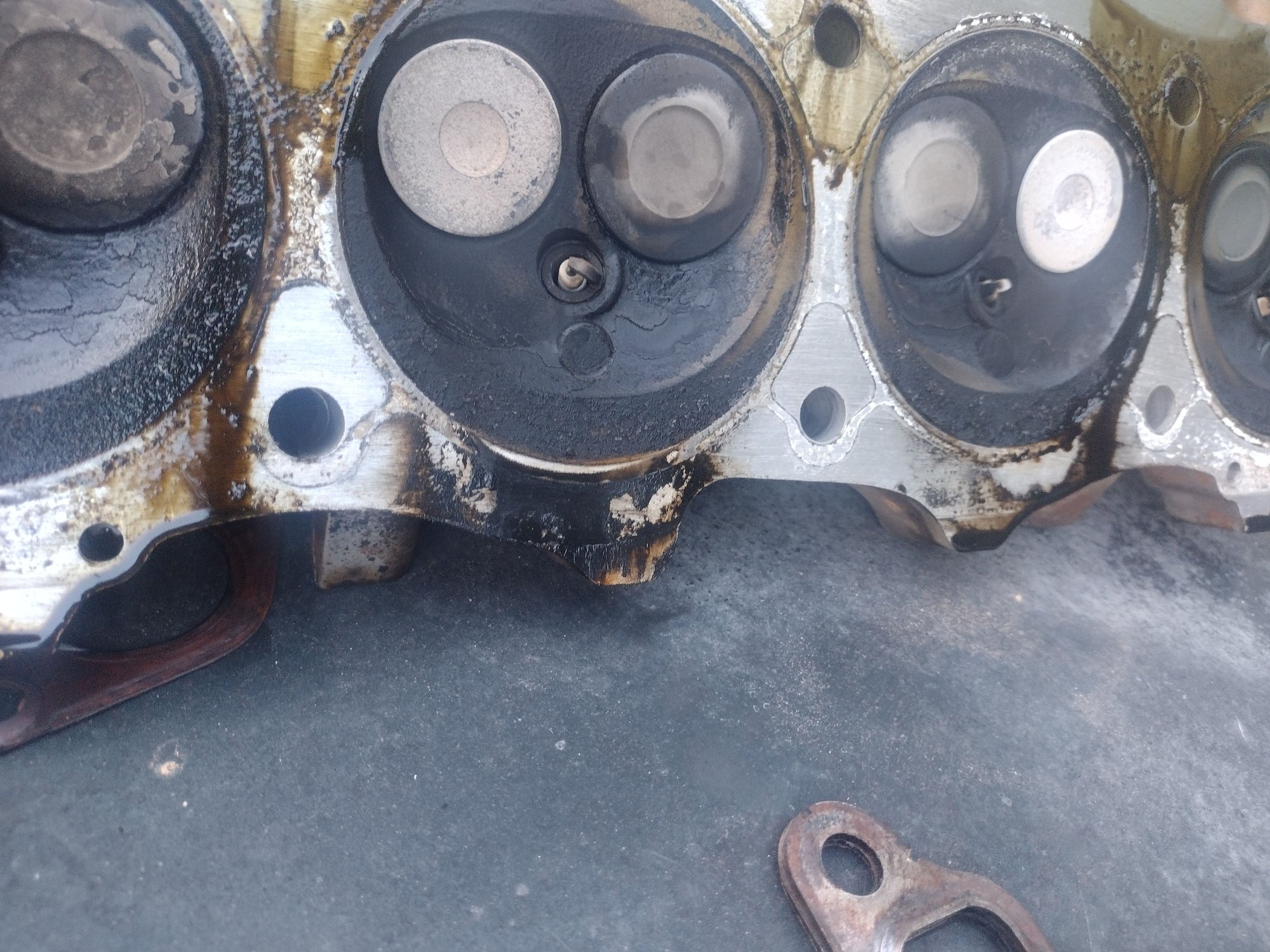

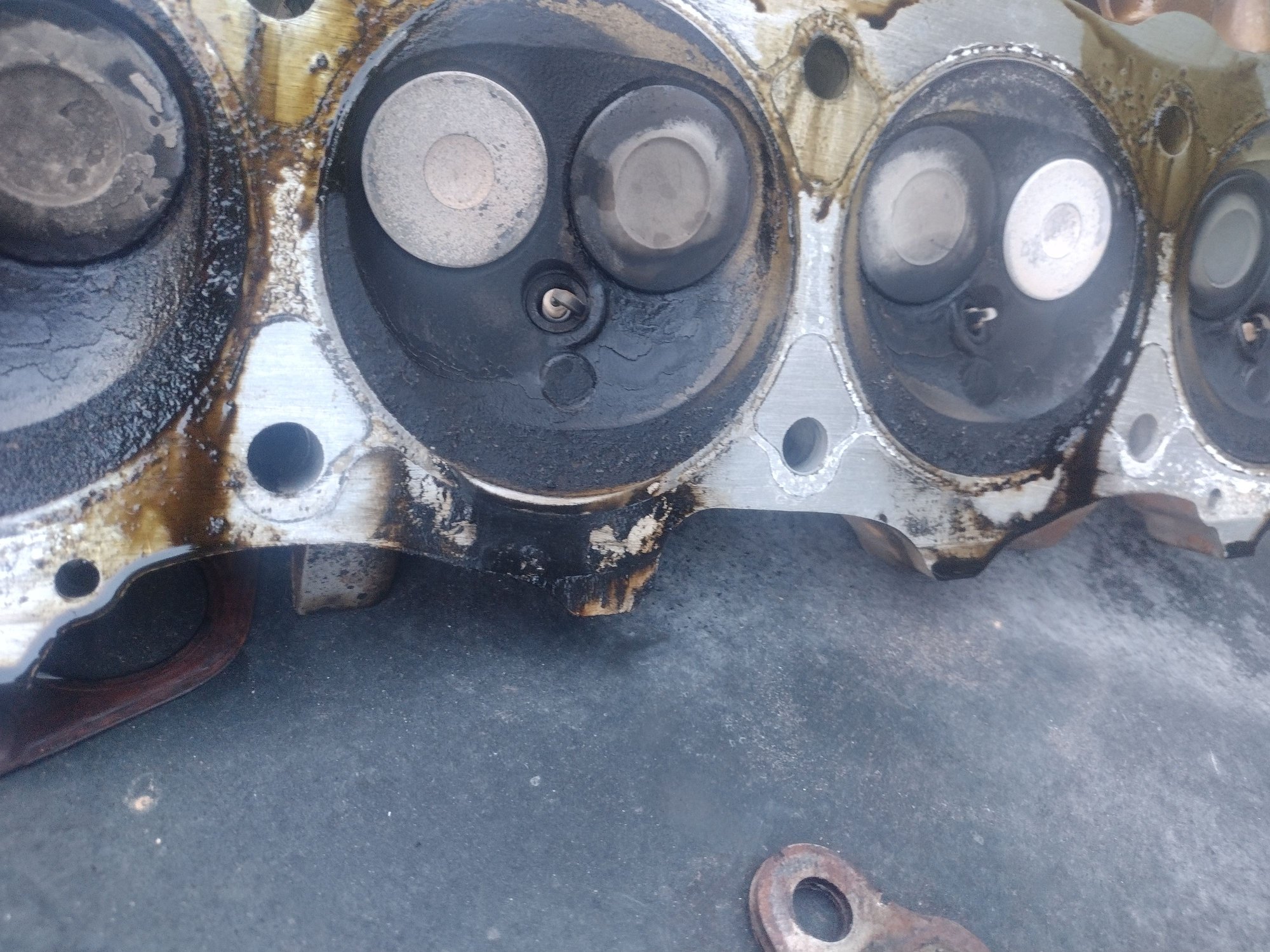

Thank you. It's weird when oem manufacturers put different part numbers in interchangeable parts. I will examine each housings and use the best looking one. Sadly the new parts rover shows an oil pressure light. The parts low mile rover I was told jumped time so who knows. It appears the pfft pfft pfft noise i hear when the engine is under load is a head gasket. The woes of a daily driver disco. I get to remove a head this week. I'm very glad I put on arp head studs last December.
Likely blew as the head started pouring coolant like a water fall last xmas eve. Was a slow leak for months before. Had the studs and gasket set on hand already. I "trued" up the heads as well as possible on a concrete block to get it going with what little spare time I had on Xmas day. Wasn't my best work but got her back on the road in sub 24 hours. The head will be sent to a proper machine shop this time so long as the block deck looks good.

h haven't had a chance to spin the motor over. Driver's head is going to the machine shop in the AM. I don't see anything too bad so far. Will play with if more later this winter. Main goal now is getting the daily driver back on the road today.

Had a little lift issue
