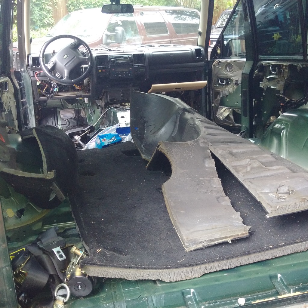

Yesterday was interior day.

From this morning:
The interior is bare metal.
I am taking off the oil cooler and lines for the 4.6. Also got the wabco abs, radiator,, BCM computer, air bags, fuel pump, the little plastic doo dad that holds the fuel door closed, spare tire carrier, etc. I have to remember to get all of the transmission/TC mounts too. The heat is frying my brain.
