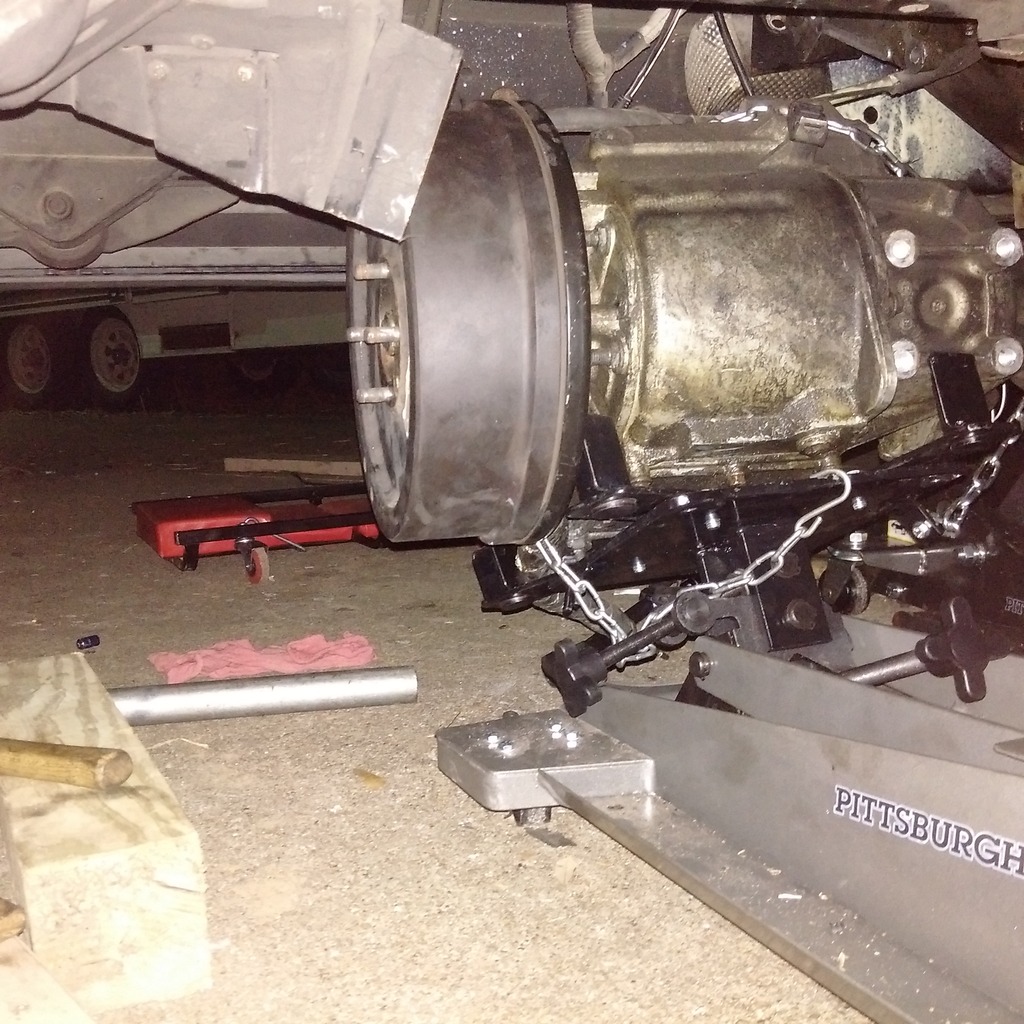

Transfer case out. Finally getting to the parts I care most about. UPS is bringing me goodies every day and I just lack the oil pump kit and timing chain. Managed all this while grilling chicken and cooking vegetables. Unfortunately, I didn't get to eat.

Always, ALWAYS remove the e brake drum before trying to remove the transfer case. If this wasn't a donor vehicle I would have had to shove it back together to take the drum off. You can see what I did to make room for the drum in the top left of the picture. I'm so glad I got to practice on this truck before tackling my own.
Also, a transmission jack with a tilt table on top is a must, as are a chain or straps to hold the case to the table. This thing will tip and crush you otherwise. I really wish our transfer cases could be clocked about 30 degrees for driveshaft angles.
