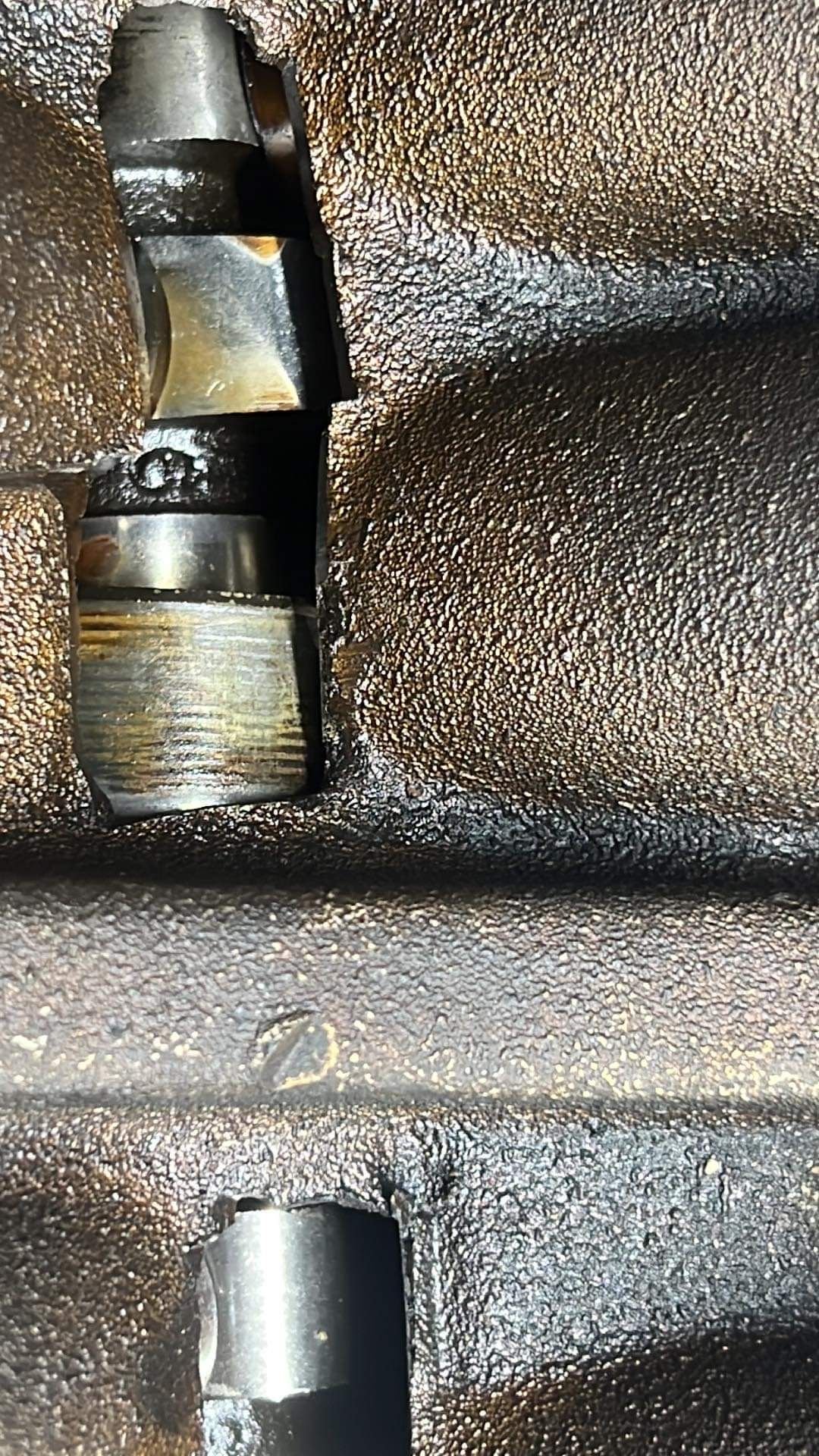

well, I was putting my 2004 4.6 back together when I found this. I was doing a head gasket lucky 8 top-end rebuild kit. and there it was. it wasn't slid back so far I did the with my finger. my questions are should I buy the upgraded cam bearings, what cam does everybody buy, and should I try and leave the block in the LR or pull it. thanks in advance.

That stinks. But a question, what are we looking through there? (the hole?)

@nashvegas About have way down in the photo you can see a piece with ridges on it, that is the camshaft bearing. It should not be visible it has moved out of place on the forums it is often referred to as walked

Yep, I see that. I'm wondering what "hole" / "access hole" we are looking through to see it, if that makes sense ? Is there a hole in your engine ?

@nashvegas ah yes they all have that some look nicer than others
