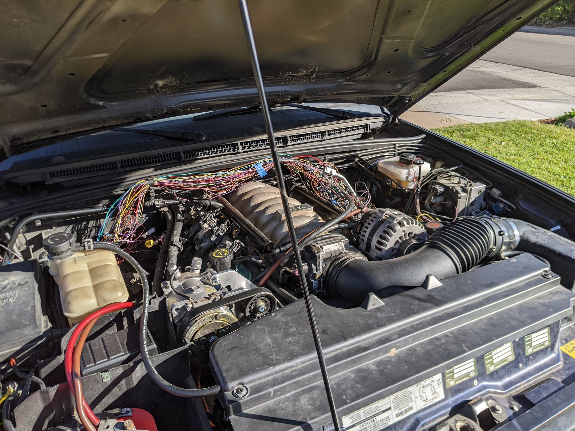

Can’t help with the bolt pattern, but ACE kit uses an LS ECU that controls the engine in stand alone mode. It then feeds necessary signals into the rover ECU through a “translator box” to control the 4hp24. The conversion that uses the rover ecu to control LS is a different conversion kit.
https://www.trailhead4x4.com/lsd2
and as far as I know they only offer this as a service, not a DIY. They use the rover sensors to control the LS and retain the rover ecu to control everything. No in between conversion box.

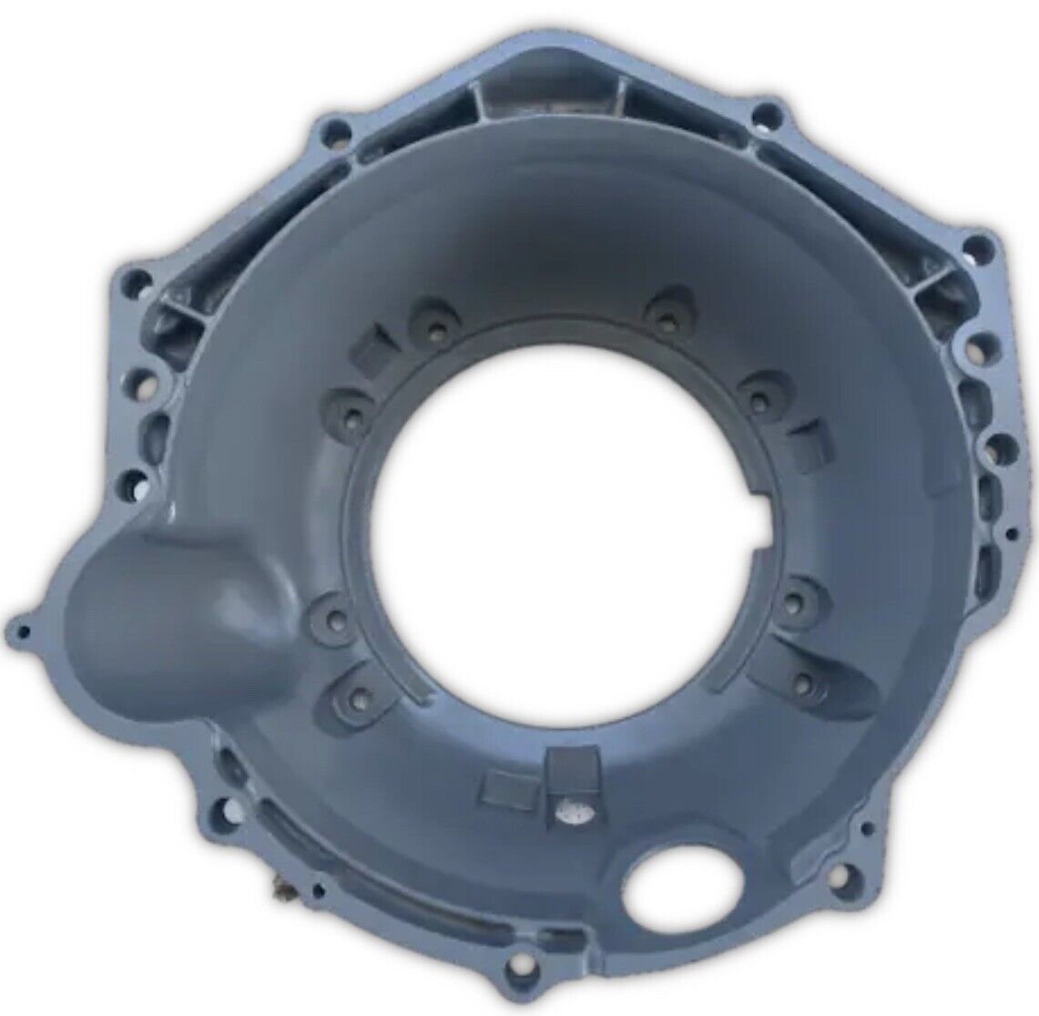

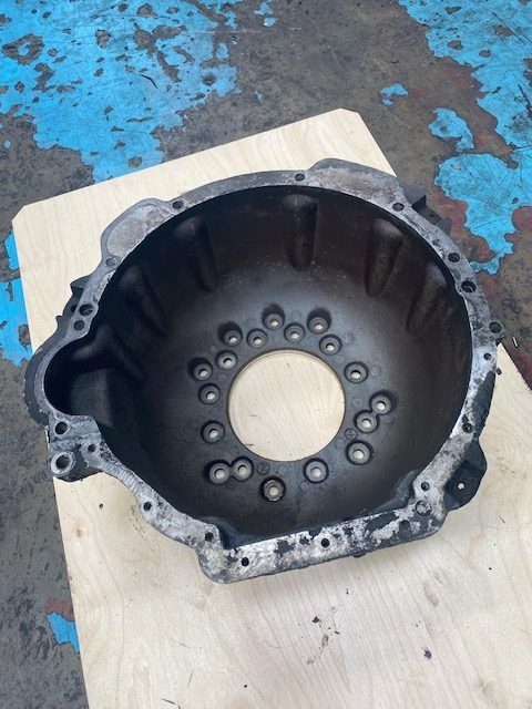

To your first question, I am doubtful the trans has this bolt pattern. It is possible since the Rover V8 is a Buick based engine. I have the Rover sitting in the garage with two transmissions separate. I can take some measurements. Here are some photos of actual differences in bellhousing shape.
So first is two BOP housings, next is a Rover housing, and finally the GM/LS housing. My own suspicion is that ACE was buying these removable bell housings and having the center section of the Rover bell housing welded in or the pattern machined in. Also, the BOP pattern is very different from the LS pattern. I am very curious if the Mark's 4wd adapter for the Holden V8 to Rover ZF would work. When I talked with them, they didn't think it would. I think the mating of the two would work. I think their fear was more along the lines of getting everything working electronically. https://www.marks4wd.com/mfk564ta.html
