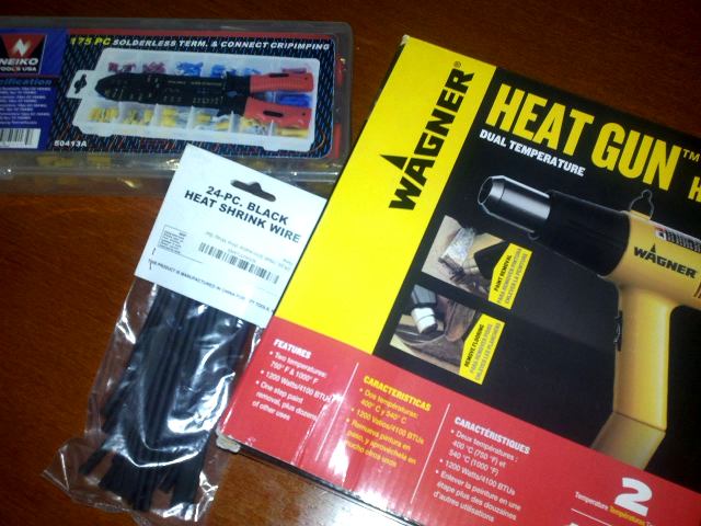

Old Sep 17, 2012 | 12:36 PM
Antmen's Avatar
Joined: Apr 2010
Posts: 342
From: North Jersey
Got these in the mail today... ready to go!
I already used it to repair a broken Nintendo DSi wall charger. Boom!
-Anthony
