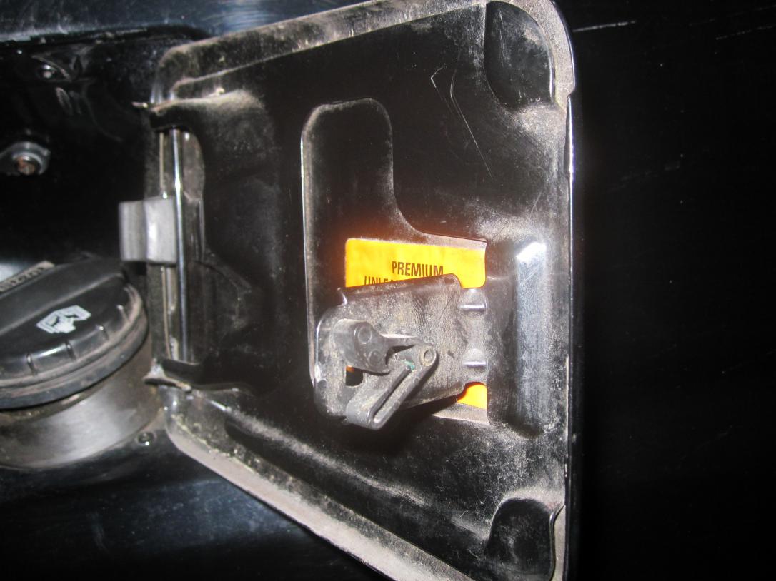

Also my fuel door keeps opening while driving. Is there something I can do to keep it secure?
It's happened before and I used bubble gum to keep it to stick(gross I know) but it worked. What's causing it come loose?

It sounds like the door clip has worn out, its made of plastic and over time loses tension. I fixed mine by placing a piece of 16 ga electrical wire cut to 3/4" between the space on the clip to increase the surface area that engages on the door latch. Hope this helps, I know a pic would be better but can't post one right now so if you do need to see what I described above I can have one for you tomorrow.
Let me know if this works for you as the 03 door latch should be the same design as on the 02.

The replacement latch is $4.95.

Yup...5 bucks, but expect the replacement to start doing the same at some point...some sooner than later as the solenoid pin (operated by the switch) is sometimes worn as well.
