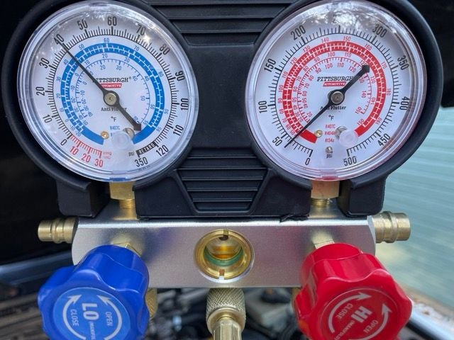

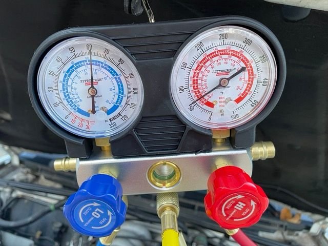

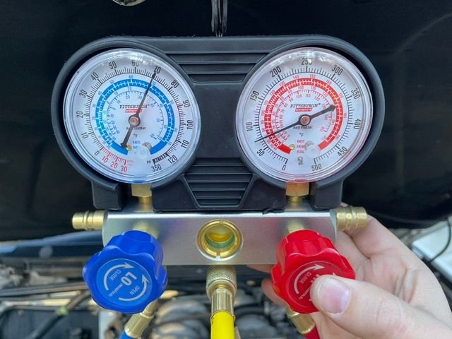

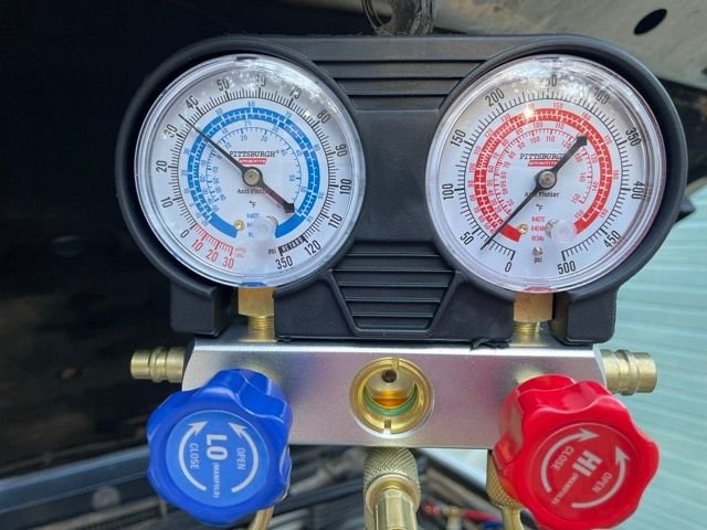

So, I purchased AC manifold gauge (I'm venturing into unknown territory here) and hooked it up this evening. Here's what I'm seeing and would love your help interpreting!!
I put descriptions below each pictures, but here's the summary:
1. Attached gauge to cold engine (image 1)
2. Turned on engine and ran for 5 mins; then turned on AC at max and lowest temp (remember, the fan does not blow) (image 2)
3. Readings after 2 minutes elapsed time (image 3)
4. Readings after 4 minutes elapsed time and after engine was turned off (image 4)
(1) Attached to system - cold engine (not running)
(2) Turned engine on & ran for 5 mins; then turned on AC at max and lowest temp
(3) Readings after 2 minutes elapsed
(4) Readings after 4 minutes elapsed & then engine off
