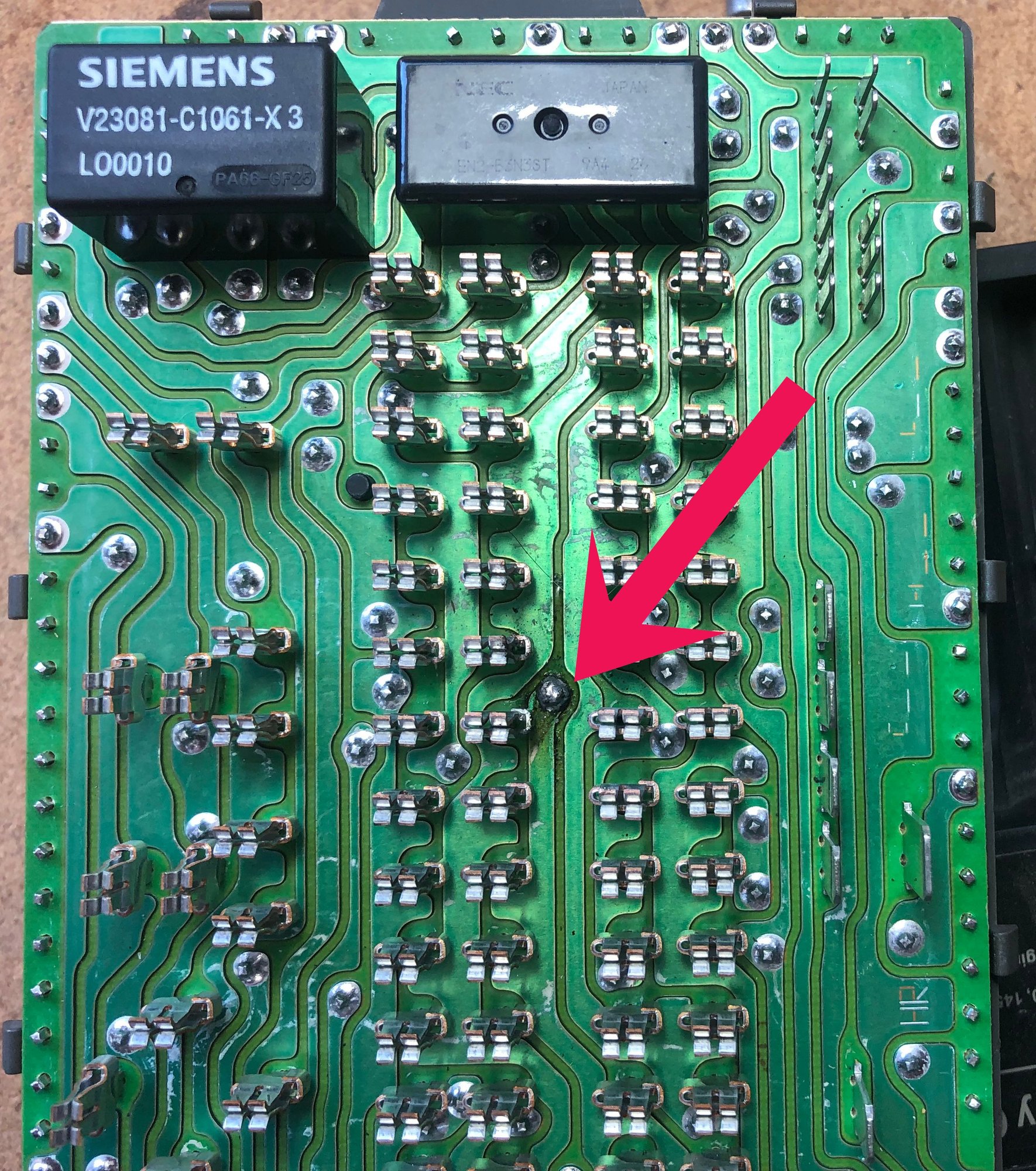

Had the same symptoms this past summer. It showed 12V at the fan but the fan wouldn't run. I left the lead from the multimeter connected to the fan wire while the fan was still connected, but then it wouldn't show 12V. The load of the fan would heat the bad solder joint in the fusebox and disconnect it. Remove the fan and it would show 12V again. I took the fuse box out and apart, found the bad joint at the arrow on the photo and added a little solder and reheated the joint and it's been fine since. I did have to buy a better soldering iron that I could get into the tight space, but not expensive off amazon.
Big photo so it can be seen clearly.
I’ll give this a try…sounds promising!! I’m at my wits end with this issue.

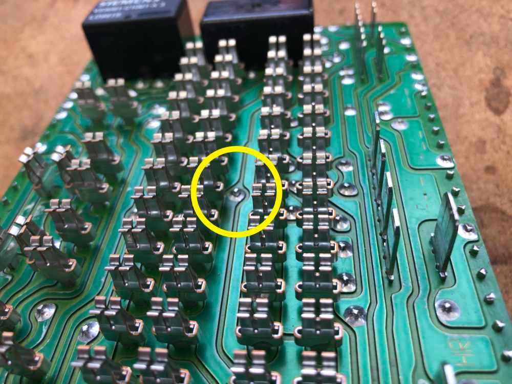

One of my other trucks just had the same problem. On initial check it looked ok, but on closer magnified view, there was a crack in the solder. Same spot as the other one.
