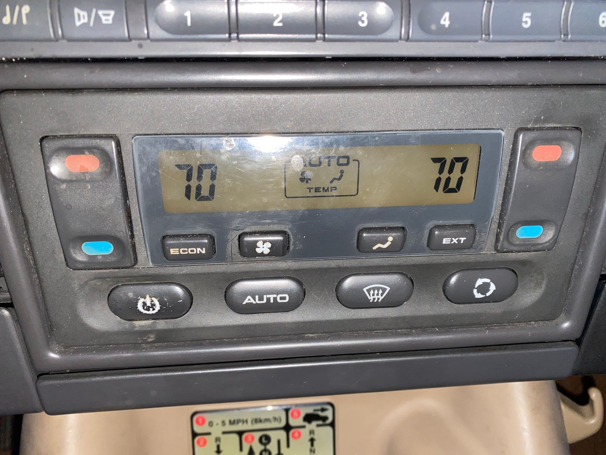

Quick question...the led screen for the heater/AC controls do not light up at night. All other dash lights work, but this and the clock do not light up at night. Unit works just fine, but I can’t see the settings at night. Same for the clock next to it.

Both have bulbs that you can replace. Just remove coin and ash tray, then clock and switch pack drivers side of heater control head unit, then you'll see a couple spots on the head unit that need to be depressed to slide the unit out. Once out, it takes a little disassembly of the head unit...but the bubs are inside. Clock is self explanatory, bulbs easily visible once removed.
