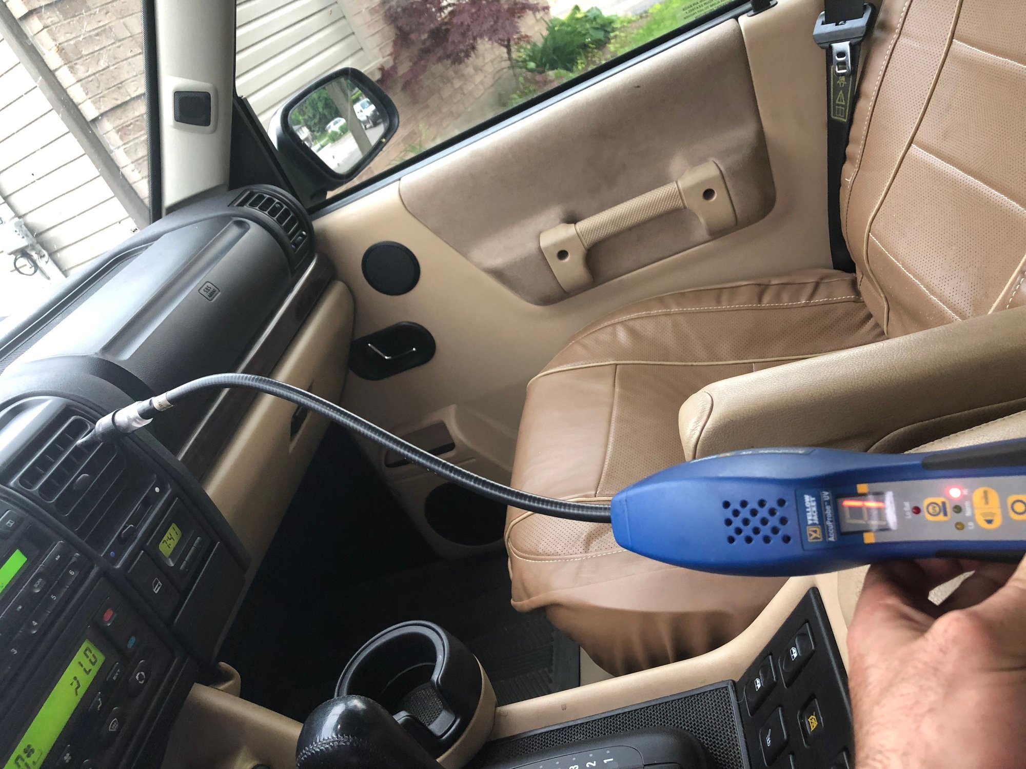

Think I found my ac leak

Old Jun 5, 2020 | 09:15 PM
XRAD's Avatar
Joined: Feb 2019
Posts: 1,288
Likes: 445
well that sucks . Could be the evaporator or one of the fittings buried deep in the ac/heater core?
Old Jun 5, 2020 | 09:48 PM
redwhitekat's Avatar
Joined: May 2011
Posts: 2,768
Likes: 396
From: kitchener, canada
i think the fittings are outside in engine bay

Old Jun 6, 2020 | 05:59 PM
XRAD's Avatar
Joined: Feb 2019
Posts: 1,288
Likes: 445
I think there are at least two nut connectors ( near the pressure regulator/expansion valve) for the coolant lines next to the evaporator.......
