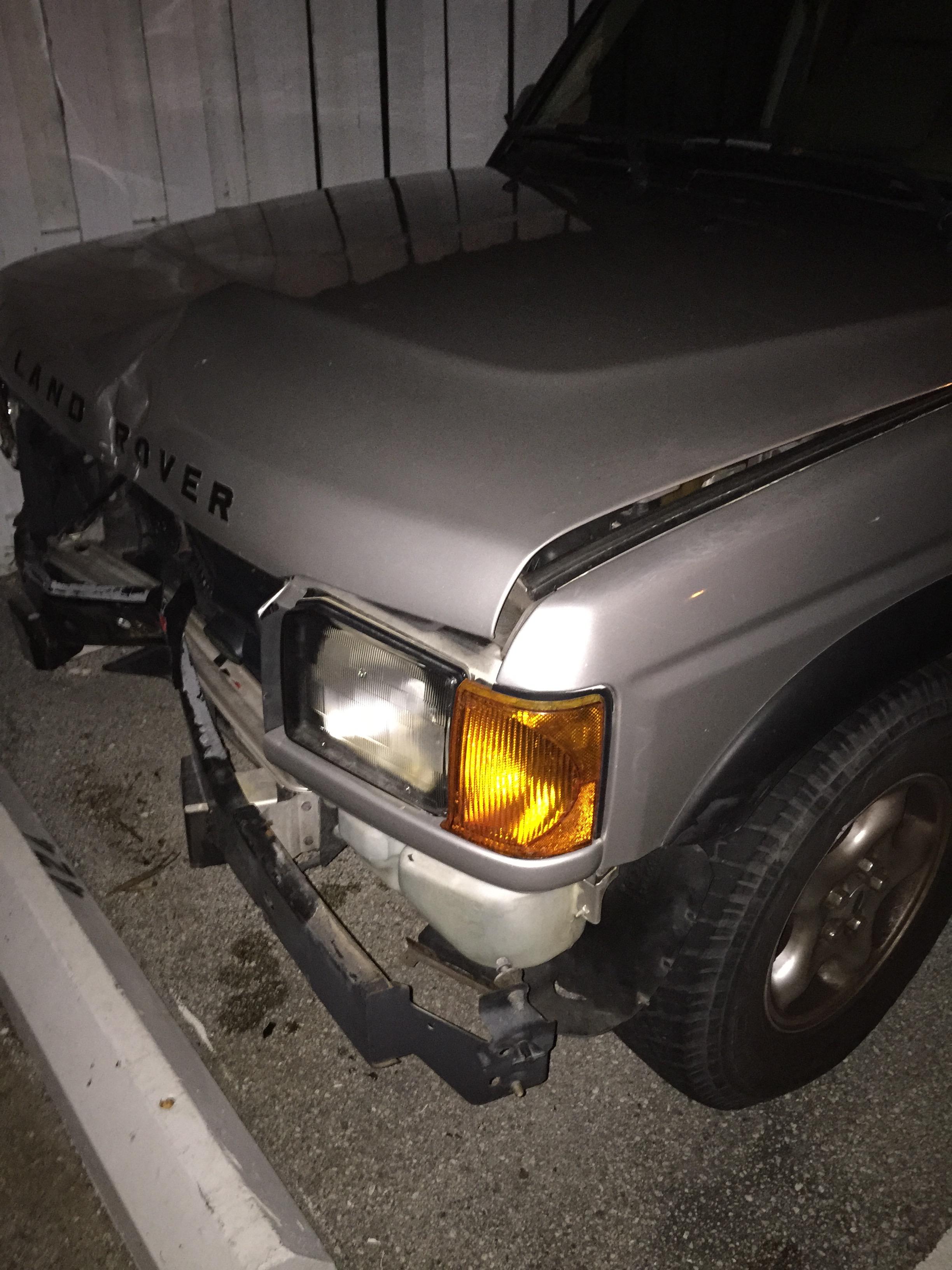

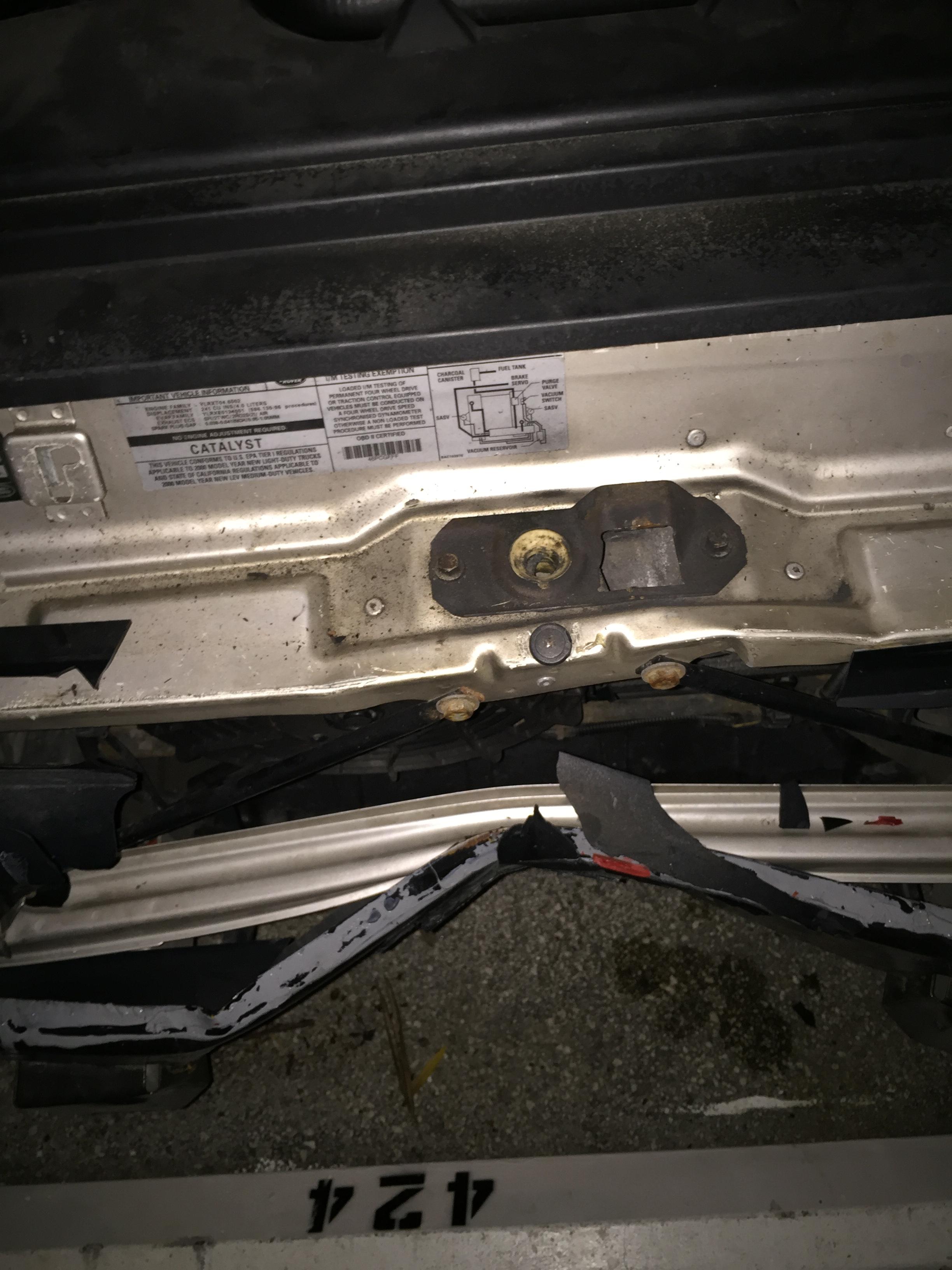

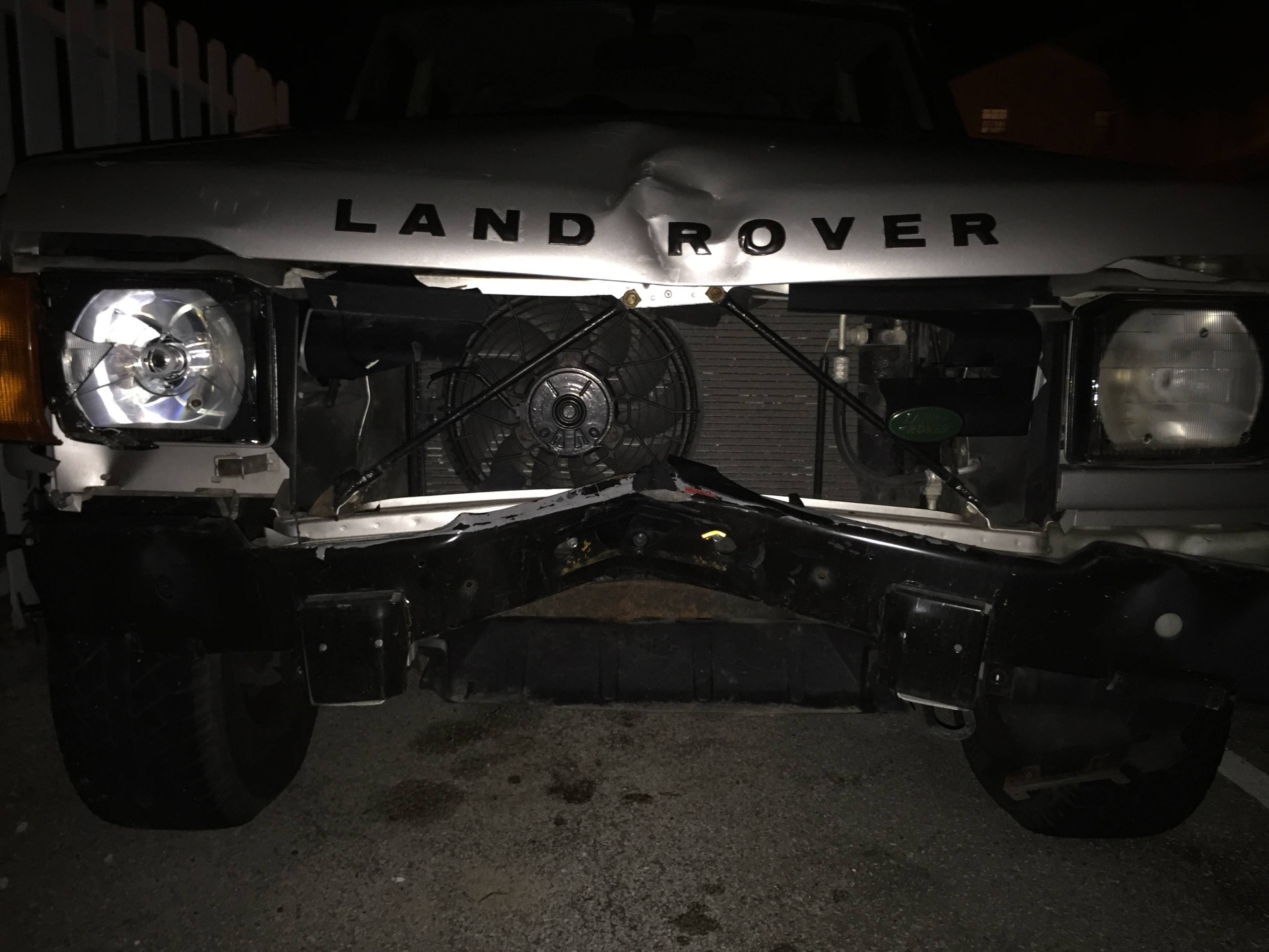

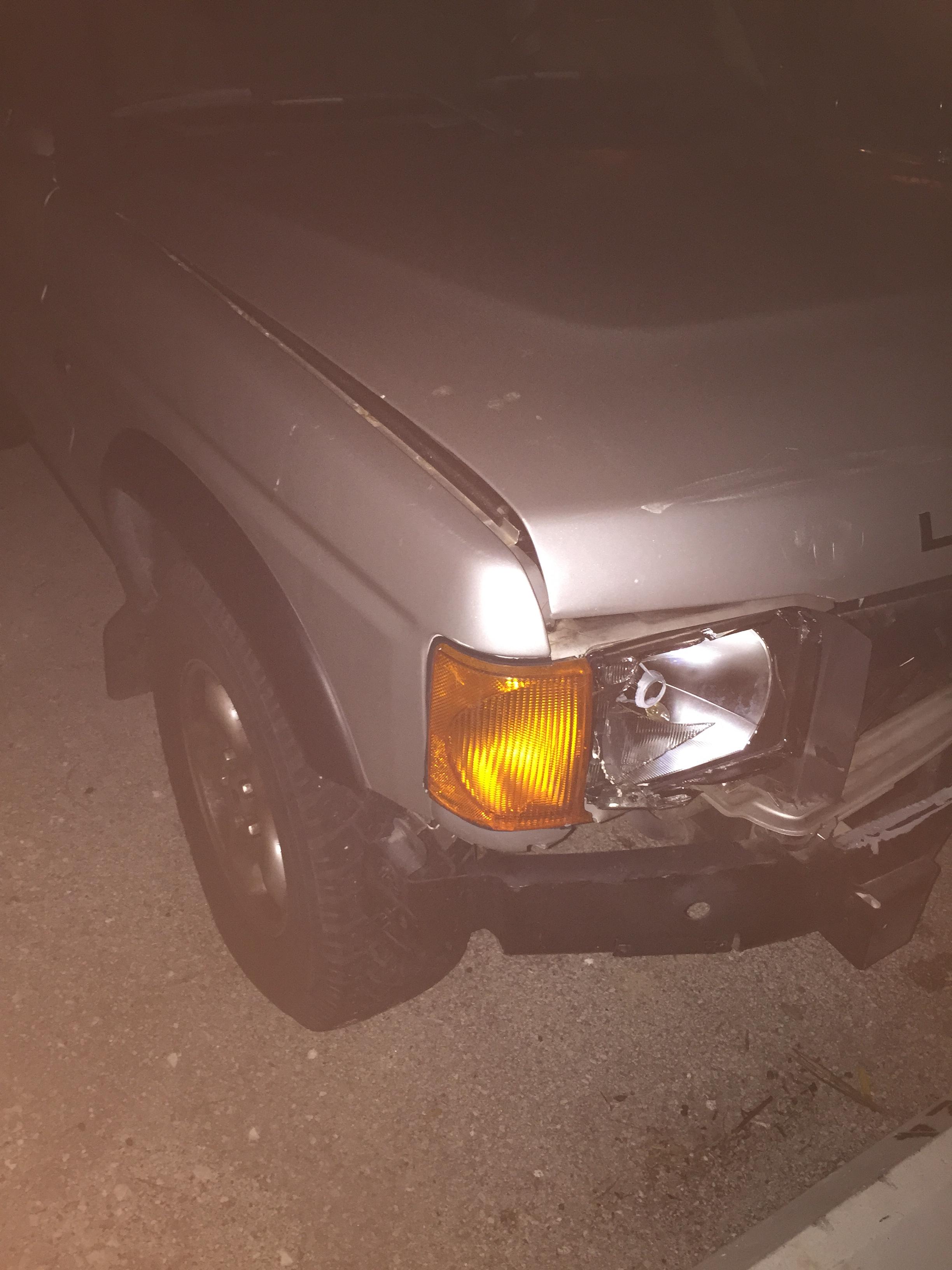

So I managed to take a few photos of the damage done to the car. So far I've determined I need a new grill, front bumper, hood, and right head light. Not sure what I can do about the area for where the hood locks, maybe sledgehammer it back not sure. As-well as the long metal piece bent inwards. Not sure what that is.
As for the A/C I checked the interior fuse box and the fuses for the fans were fine, check the exterior fuse box and R6 which seemed to signify the fan was a huge fuse which was something I wasn't expect so can't be sure if that's blown or not. Anway it'd be nice if you guy can check out the photos and tell me what else needs replacing.
Also the fan infront of the radiator doesn't turn on and I'm not sure exactly what it's for. I was told that is turns on at the appropriate times but not sure.
one more note, I took these photos at around 7 or so so its a bit dark. If its too dark to recognize details then ill try and take a daytime photo whenever I get the chance.

hey, you kept the green oval, at least.

electric fan in front of the radiator should turn on when engine temp hits 210.
Run 12V direct to see if it works, if not you should replace it. Hey, I just happen to have one I can sell you! Imagine that...

^ yeah it looks like it could have been involved.
I've got a grill of a 2000 or 2001.
about that.. after closer inspection it just happened to stay in place, after touching it it simply fell out broke my heart for a second cause I liked that logo. I'll give the fan a try but Im gonna assume its fine.
