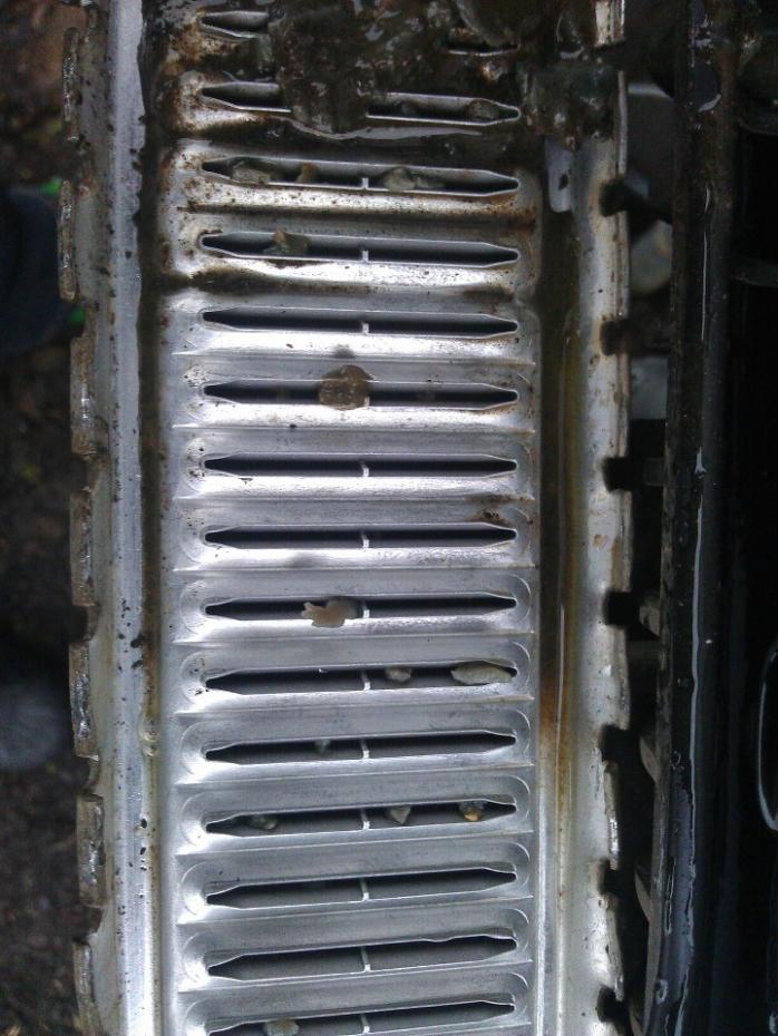

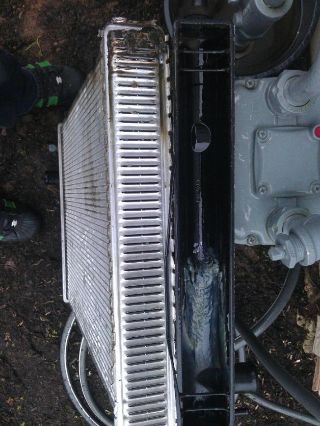

When I bought my 01 Discovery last week it was so low on coolant, due to a leak, that I had no idea what had been used previously. I added two gallons of "universal 50/50" so that I could get the truck home. It has sat parked until yesterday when I replaced the throttle body heater and both lines that attach to it. The Asst Service Manager at the dealer told me to flush the system and go back with DexCool. I am hesitant to do that, but what do Y'all think about a good flush and then using Zerex?

1. You will find that many dealer proposed solutions are the most costly possible.
2. Here is a TSB from GM on how they advise to flush Dex, just don't re-place with it.
3. Radiator chemistry is enough of a problem on its own, with various chemicals in the water "cooked out" over time. You can find scale buildup in a home water heater, it has neve seen Dexcool, but has been cooking tap water for years. Distilled water should be used to do the final flush out. 50/50 premix coolant, like Peak, is good.
4. Dex takes radiator contamination to the next level because of unintended consequences. No one meant for it to happen this way, they just did not consider all the real world variables in their planning and life cycle testing. What works in a sterile sealed air conditioned research lab frequently has new challenges in the real world.
5. Sludged up rad will usually be cooler on the bottom rows, as they have little or no water flow. These are horizontal row radiators, all tubes are fed in parallel.
6. Here's some pix of Dex mud, and of rad with non-Dex issues (scale, left over stopz leakz). Stopz leakz usually works by sealing a tiny spot in the cooling system with a couple of drops of material. The rest of the jug of majic elixer has to go somewhere, and gravity will take it to lower rows, and sometimes heat will allow a blob to move about like the stuff in a lava lamp (ask your parents). The scale in the rad passages provides small rough spaces for the stopz leakz to seal up as well, hey, it is just doing what it was designed to do, squeeze off small passages.
