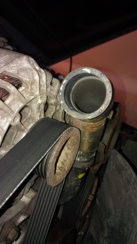

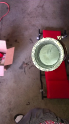

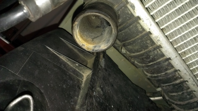

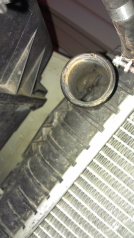

I found out my viscous fan spins, so Im gonna replace that and put in a new thermostat before splurging for the radiator just yet (though you'll see I probably need to soon).
In the mean time, I have some pics of the results of dried Irontite. Result on clean parts is a nice fine white layer of coating. Dexcool-poop stuff, not so much...

Most likely will be needing that radiator, unless you started with a new one.

Nope, as you can see, that one had a nice coating of dexcool crud.
