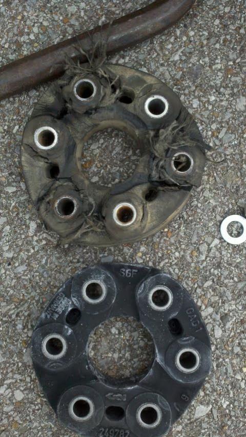

2 - Front prop shaft is a no brainer, but the rear U-Joint looks good as does the rotoflex, should I just do those anyway?

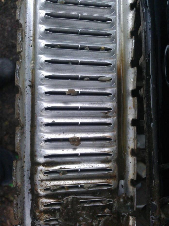

Radiator can be evalauated now. Warm up truck, engine off. Measure temp on rad fins top to bottom in a vertical line. Should be less than 10F spread. More spread indicates cooler on bottom, from less flow, through restricted tubes.

Grease the rear u joint at every oil change, eyeball the roto flex. Will show up as tears/cracks.

Replace the radiator now, even if the heat distribution looks good cause the plastic tanks, at your mileage have taken more heat then they can handle and are now brittle.
