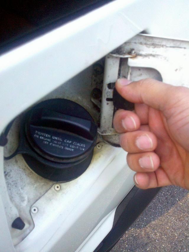

I've been wrestling with the fuel filler neck for a while now, trying to install a new grommet after the old one turned to goo.
I kind of got it installed today, but I'm not 100% confident I'm doing this correctly. The grommet has a thin side and a thick side, and I'm not sure I have it oriented properly. At first I was putting the thin side toward the outside of the truck, and I had a hell of a time getting the neck to fit. Then I tried putting the thin side toward the back, and got the neck reasonably stuck in there. Could someone with an intact grommet check to see which orientation is correct?
Here are some pictures of what I'm dealing with: Imgur: The most awesome images on the Internet

The part number is WLR000010. I got one at a local supplier, but it's also available at AB, etc. https://www.roverparts.com/Parts/WLR000010G
As you can see in the pic, it has a thin side and thick side. Still not sure if I've got it in right, but it's not moving, so perhaps it is.

You're lucky – mine turned into goo form and it got all over everything. The rubber these things are made of seems to be soluble in petroleum-based products (WD-40 wiped on it with a paper towel comes up black), which makes a WHOLE lot of sense given that it's near where you fill your gas tank.
I'm at the point of calling it done at this stage. There's nothing in the RAVE about its orientation, nor are there pictures/descriptions elsewhere online that I can find. My one piece of advice is you definitely have to seat the grommet to the body before pulling the filler neck through. You cannot put it on the neck and then seat it in the body.

Can you describe it or take the cap off? there's a thin side and a thick side to the grommet.
