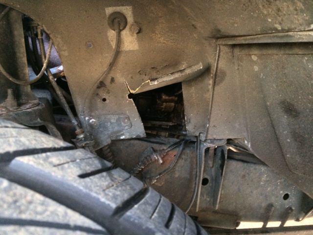

Sounds like it. I used the Advance Auto sensor with no issues. If you wanna save yourself some heartache take my lead:
https://landroverforums.com/forum/di...e2/#post443936
