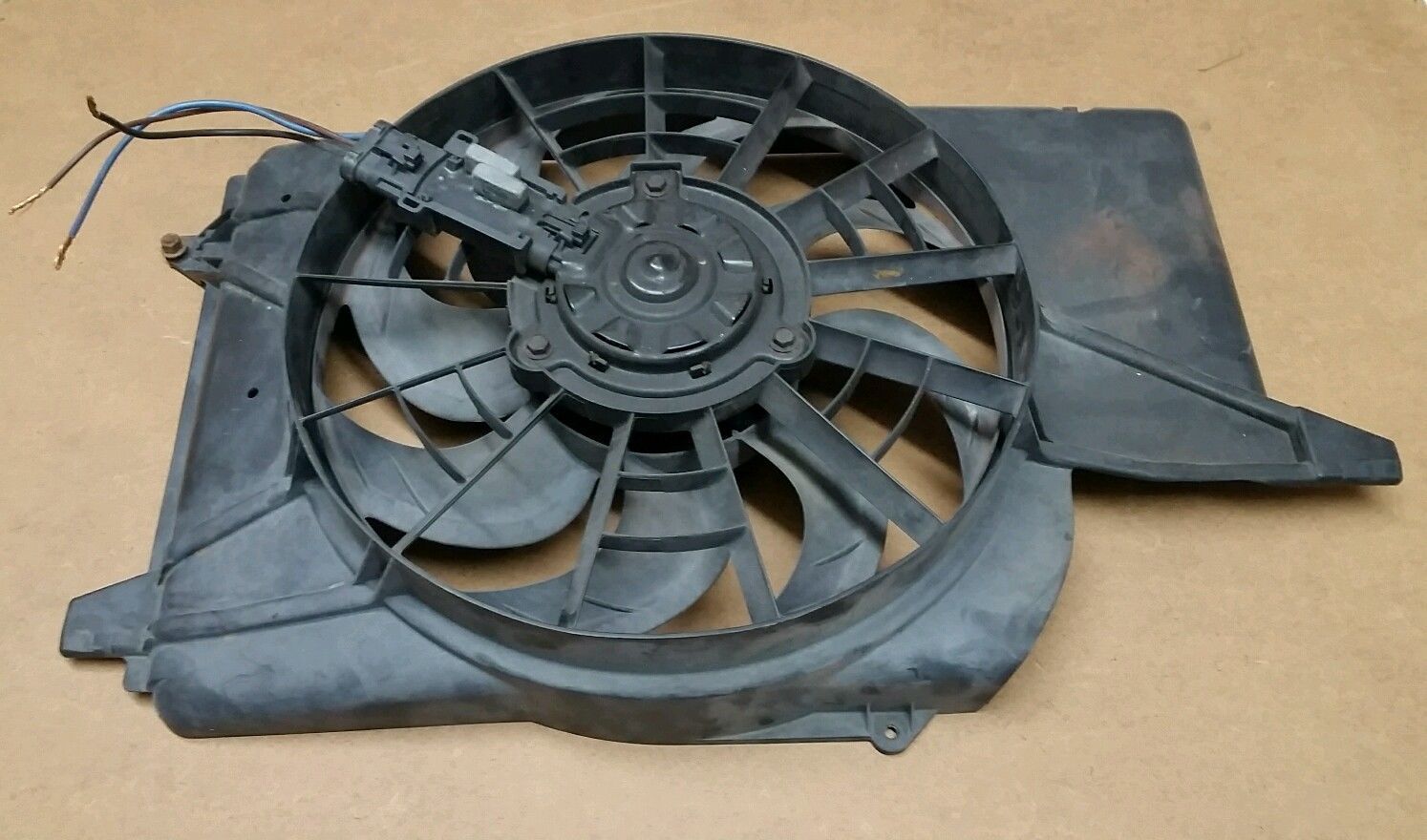

that makes sense, and was pretty much exactly what I was wondering. I see there is something inbetween the harness pigtail & the fan motor on the one I just bought, and I *think* I see it on yours as well now... what is that? at first I thought it was a built-in controller, but you said you didn't use one.
the new replacement ones I see don't have that, just a different harness lead.

So, I think I am going to be a bit of a nuisance now. lol....
could you show me what controller & relay you use? I thought I had it figured out, but confused the hell out of myself.
and do you know what is the part I have circled in red? this is my fan & I do not see that on many of the other "oem" fans. is that a relay? is all I need to do is ground this & run 2 wires to positive terminals for the 2 speeds?
sorry for the dumb questions. like I said, I confused myself & want to compare to your install.
~Matt
