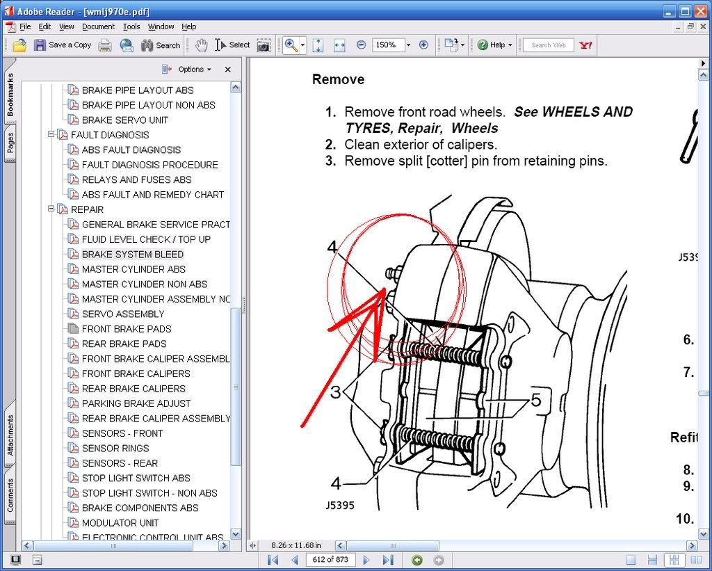

Attach a clear tube to the bleed screw on the caliper..
It will be on top of the caliper, inboard, with a little rubber stopper on it if its never been done before.
and like spike said the best way it to have her press on the brake, you loosen and then tighten again when she gets to the floor..
