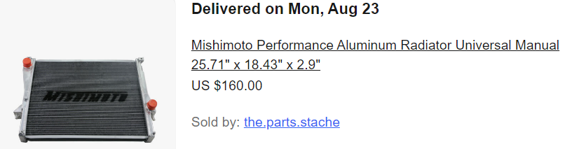

Also, in regards to your original question I bought this radiator almost 3 years ago though haven't installed it yet
