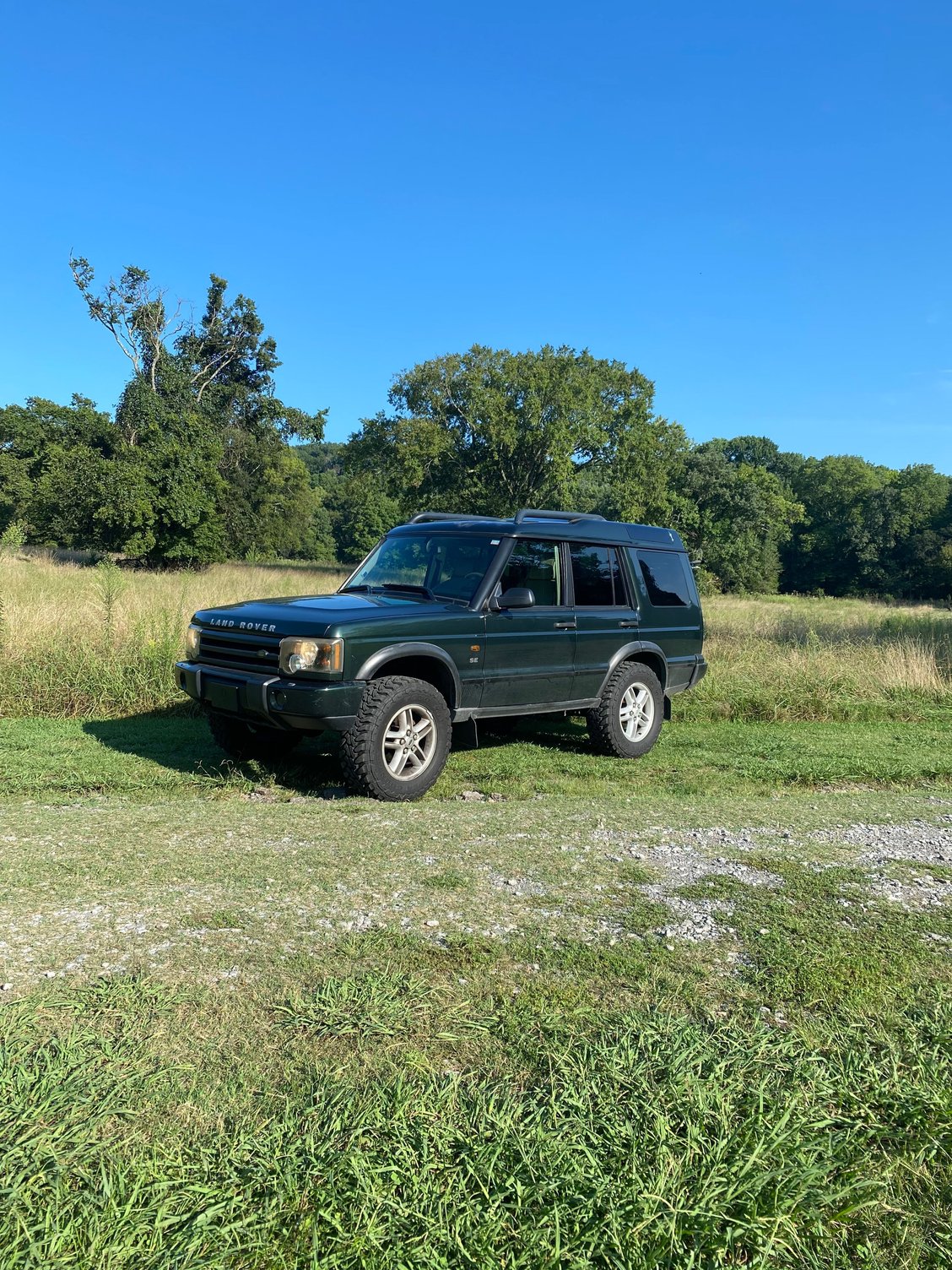

275/65/18 toyo Mts 2” RTE lift. I had to remove the inner plastic in the bumper but no other rubbing.
