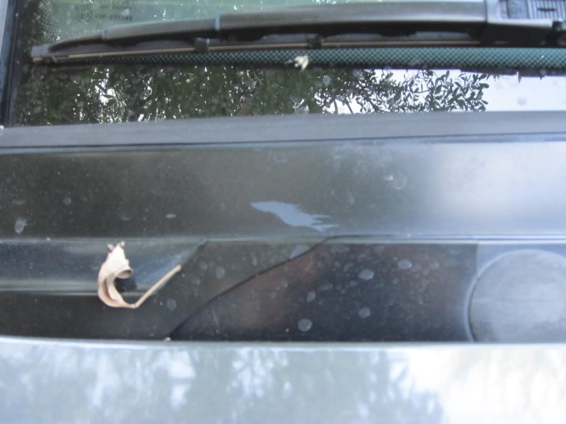

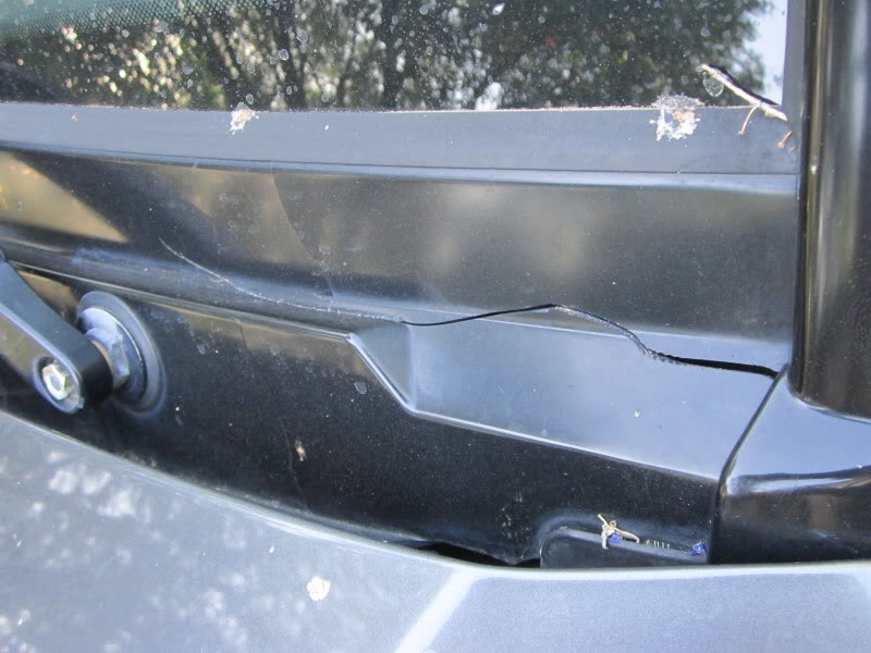

Could the following pictures be the cause of wet carpet? It is only way exactly where the area of the rubber mat covers and nothing else is wet. I havent checked after car washes to see if it gets wet anywhere else, but so far this is it. I'm gonna let it dry with the sun and windows open. It does not smell but on to the pictures.

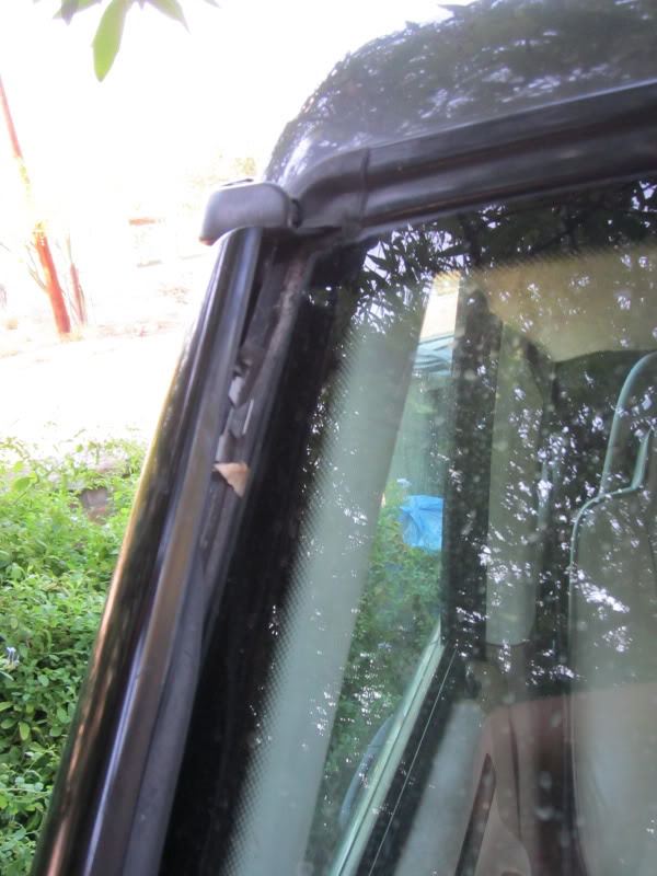

And this plastic panel is now missing. It fell off getting onto the highway...real torque there

Not sure. If your carpets are dry, take a bucket of water or a garden hose and soak the crack, then check your carpets.
If I had to guess I would say yes.
Good luck.

I am gonna try that. Just waiting for them to dry :sad:
