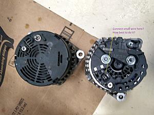

There were two wires on the back, both attached to bolts. Two questions:
(1) Should I connect the wires to the alternator before it is seated or after? It seemed like it was harder to get it to seat with the wires connected.
(2) Also, one of the wires, the smaller of the two, does not connect to a nut on the new alternator (see pic). Looks like I might need to splice on a spade connector, but the Bosch manual (Bosch AL0807N) doesn't seem to indicate what size. I've attached pictures.
Any thoughts?
Thanks again
Attached Thumbnails Bad Alternator?  Battery Light Flicker...Then Just On.-alternators-web.jpg   Bad Alternator?  Battery Light Flicker...Then Just On.-wire.jpg

To get the alternator to drop in look at the bracket it sits in. You'll see two collar looking sleeves on the front of the bracket/bolt holes. Tap those slightly and they'll move out allowing the new alternator to simply drop in.
As far as the wiring connector. You should be able to get a little slack out of the harness. If it mounts properly and it looks like the only issue is the blade connector just cut off the OEM eyelet and install a crimp on blade connector.

Thanks again Best! Is it easiest to install the wiring before or after I drop in the alternator? I can figure it out, but if you have a suggestion I'll definitely take some more advice. Thanks again!

I've done the wiring both ways. I'd say it's best for the wiring (especially the little wire) to do it with the alternator installed then just use a small ratchet to tighten them up. As long as the battery is unplugged you'll be fine either way.

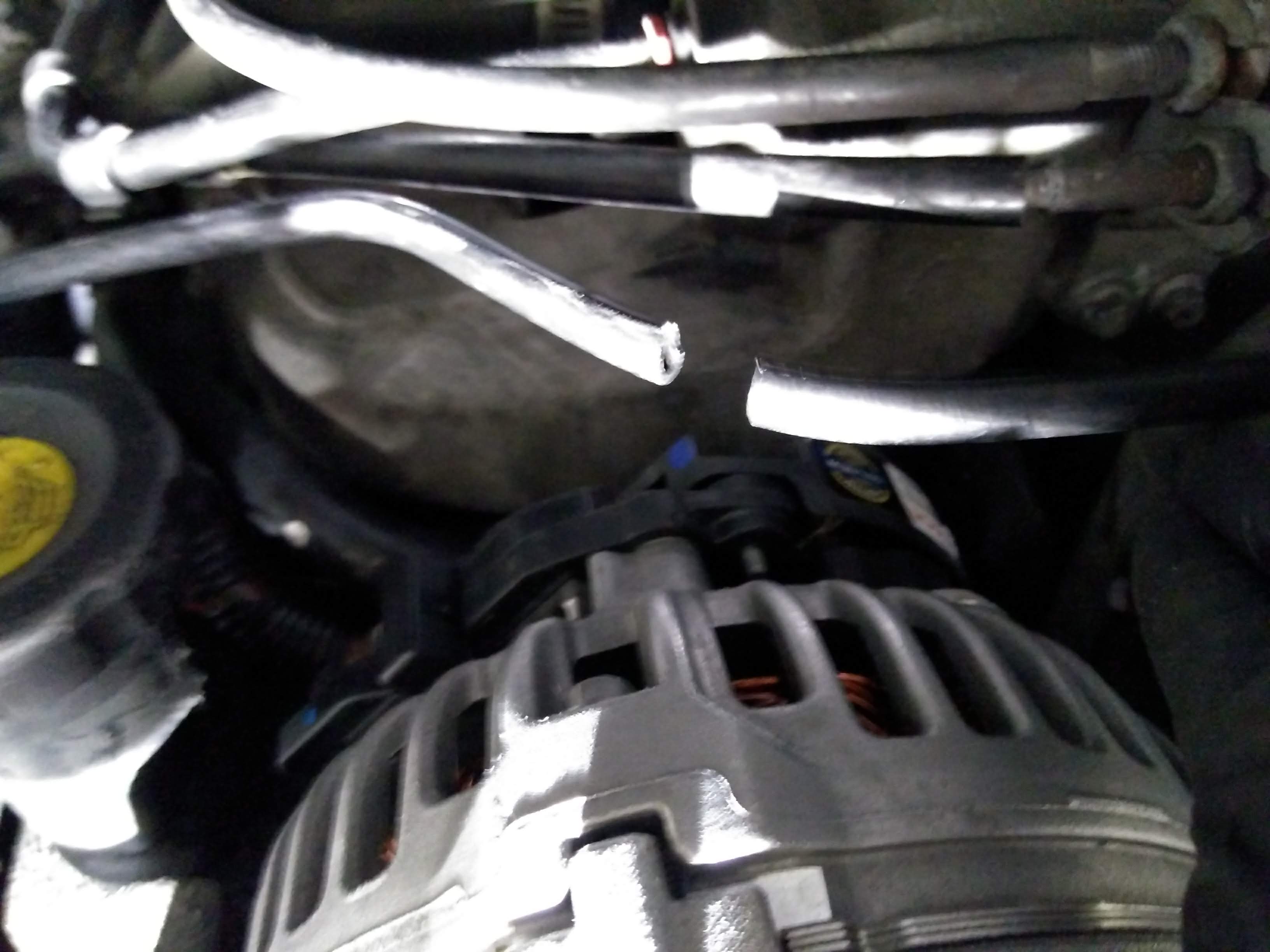

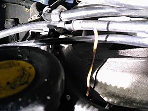

Wow, so much easier once you tap out the collars! Job went very fast after that. Unfortunately I wasn't careful enough and cracked the tubing running to the coolant. Where can I get a replacement? Is this something that Autozone/Advanced Auto carry? Anything I can do temporarily to make sure the new alternator is working until I get the new tubing? Live and learn. And thanks for all of the help!
Pic of the cracked tubing below.
Attached Thumbnails Bad Alternator?  Battery Light Flicker...Then Just On.-coolant-hose.jpg
Replace that brittle pos all the way from the rad nipple to the tank using high pressure rubber hose. Just be extremely careful not to break the nipple on the rad

You can get some 5/16 coolant hose and just use it to vs the hard line. Or use it with some clamps to fix the broken spot.
