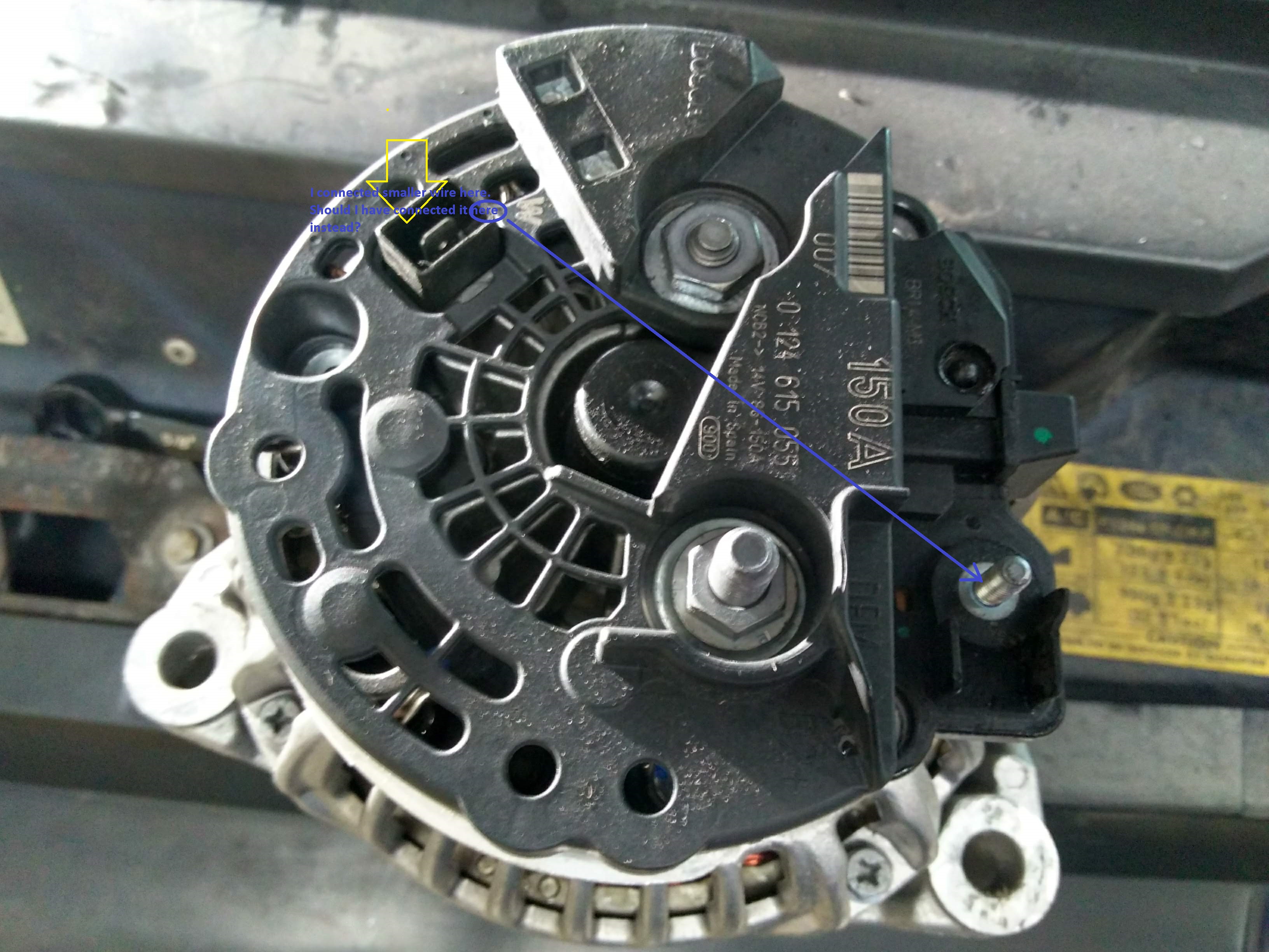

Last thing...I'm wondering if I connected the smaller of the two wires incorrectly. I ended up hooking it up with a spade connector to the spade terminal, but I'm wondering if I should have connected to the other (D+?) terminal. The manual that came with the alternator made no mention as to what went with what, but maybe it should have been obvious if I knew what I was doing. Some Internet searches seem to indicated that this spade connection might be for a "tach connection"?
Pic below of what I'm describing. Thanks.

Yeah that isn’t a typical LR Bosch replacement. I’d try the round terminal for kicks & see what happens.

Thanks Best, I'll try that when I get home today. It looks like the D+ is for the battery light, so that may be why I am getting the flashing battery light...but still not sure why I would get the fluctuating readings.

I bet, and I'd put $100 on it, but check your exciter wire connection. It runs from the dash light to the stator on the alternator. If it doesn't supply voltage to the alt all the time, you won't get any charge out.
