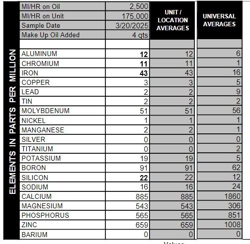

Could this be related to my knocking noise and metal particles in the oil? The knocking noise happens once per camshaft revolution. 1/2 the crank revolution. The metal particles are so fine that the oil filter does not catch them. I did get an oil analysis and got these results. Note that aluminum, iron and chromium were high. This oil sample was 3000 since the rebuild and the second oil change. Currently it is 6k miles since rebuild.
What should I do to fix this? Do I need new pistons, new rings? (I already replaced rings) I did not hone the cylinder liners as per the rave and this forum's advice. Did that cause these issues? I'm going to pull a good and bad piston to see how they compare.

High metals in the OA could just be from break-in, should decrease for the next check. The trend is what is important. The Motor Oil Geek suggests first oil change during break-in around 500 miles due to high initial metals. Try not to sweat the small stuff, these engines are work horses, not Formula 1. Easy for me to say, but it's your truck in the end.
