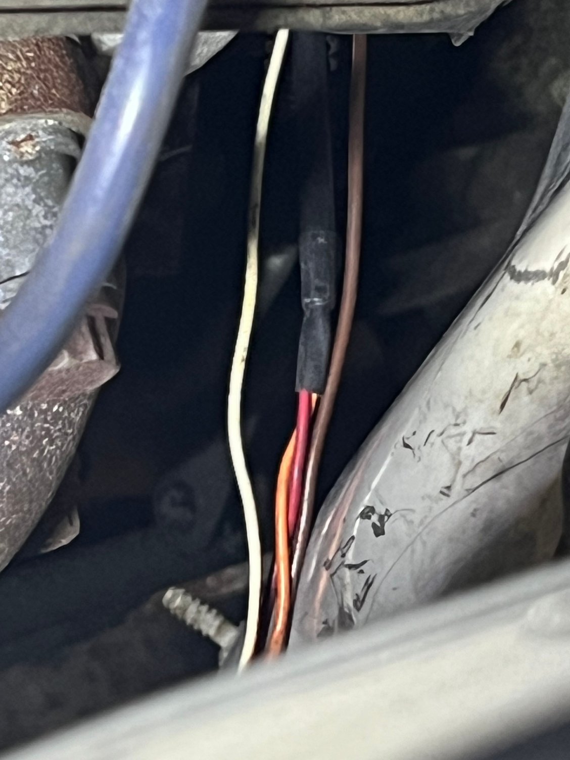

The protective wire loom on the drivers side was badly dry rotted, and came apart. Does this look typical where the red and orange wires go into some heat shrink, or am I possibly looking at a repair splice?

Maybe cut that open and check for a bad splice. At least compare to the other side.

I'll take a closer look at that heat shrink looking section once it cools off again. Any insight if that heat shrink area looking area looks normal? Or does it look like a splice.
