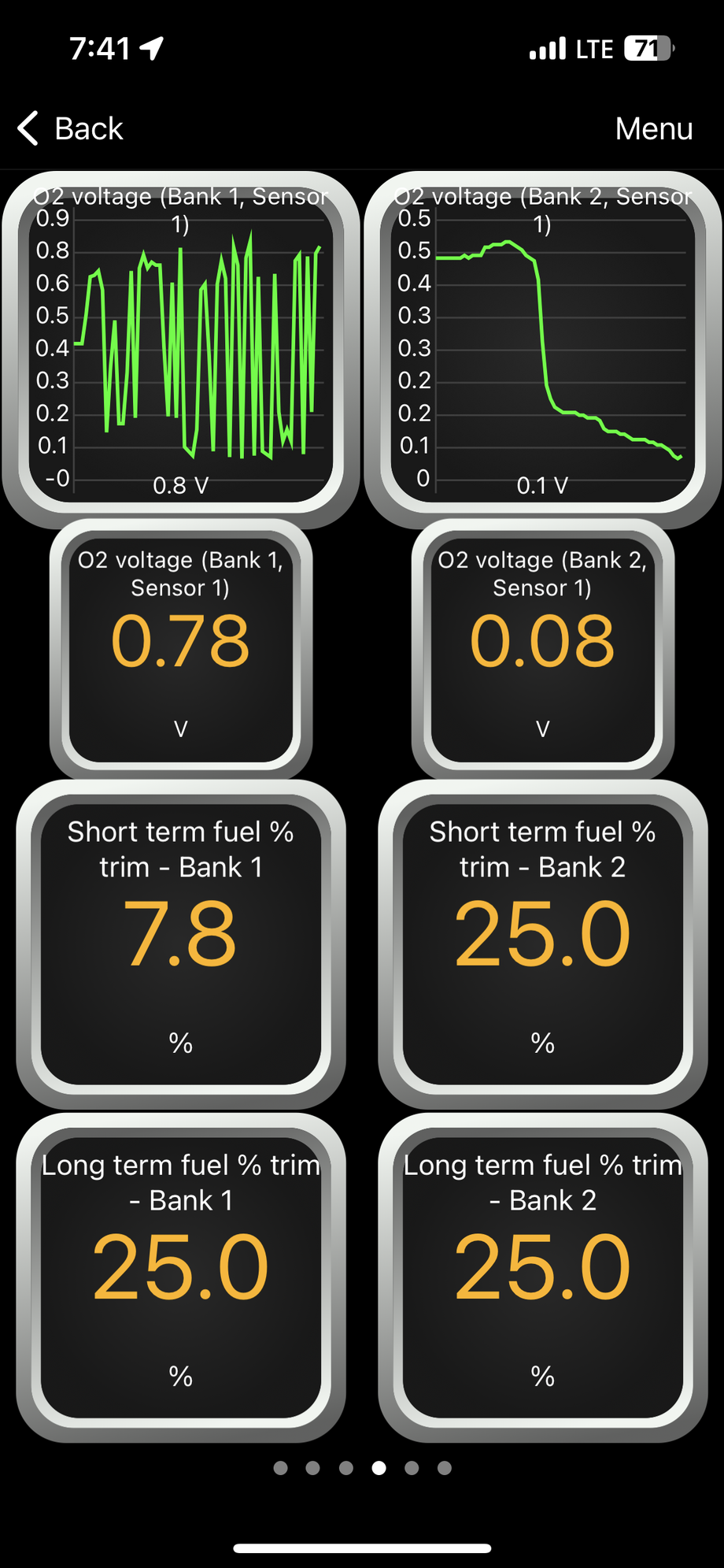

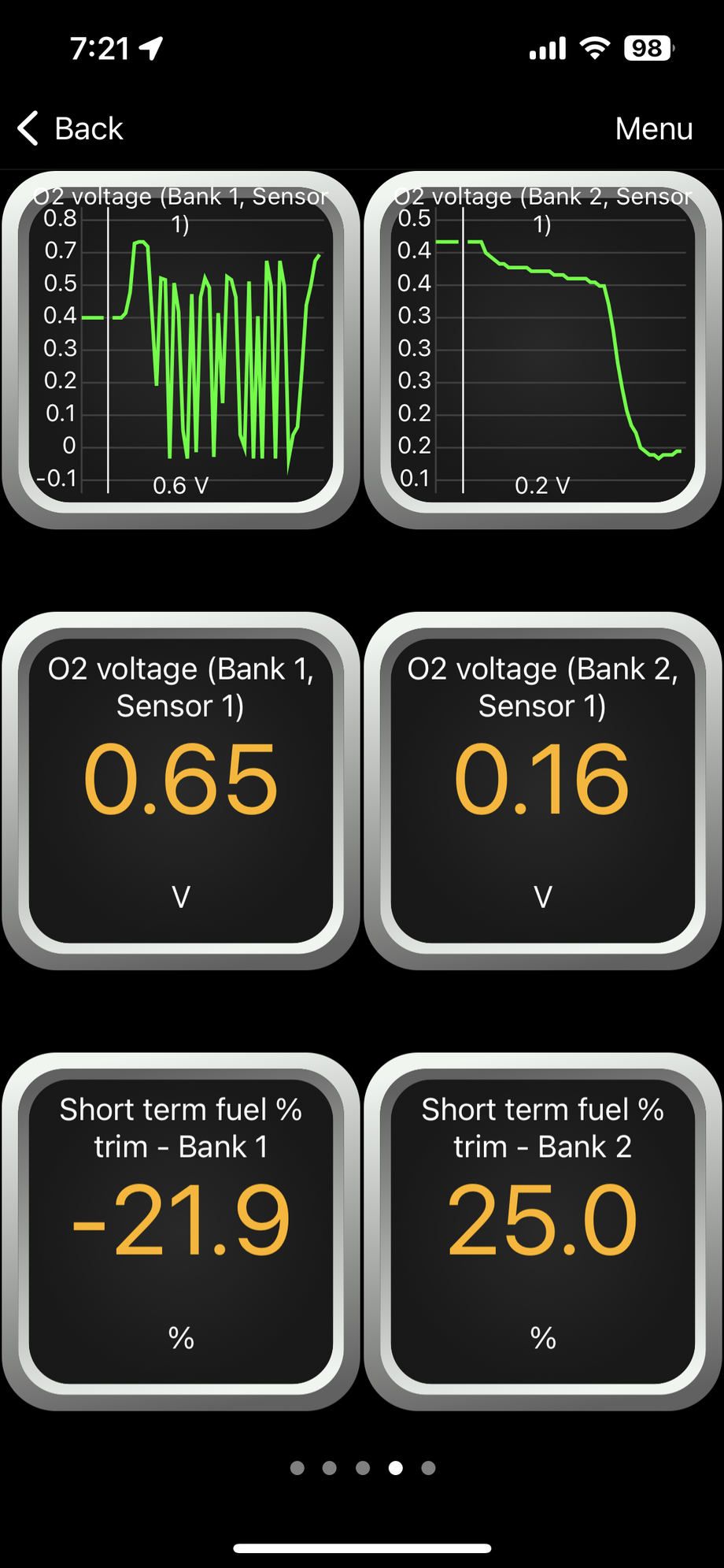

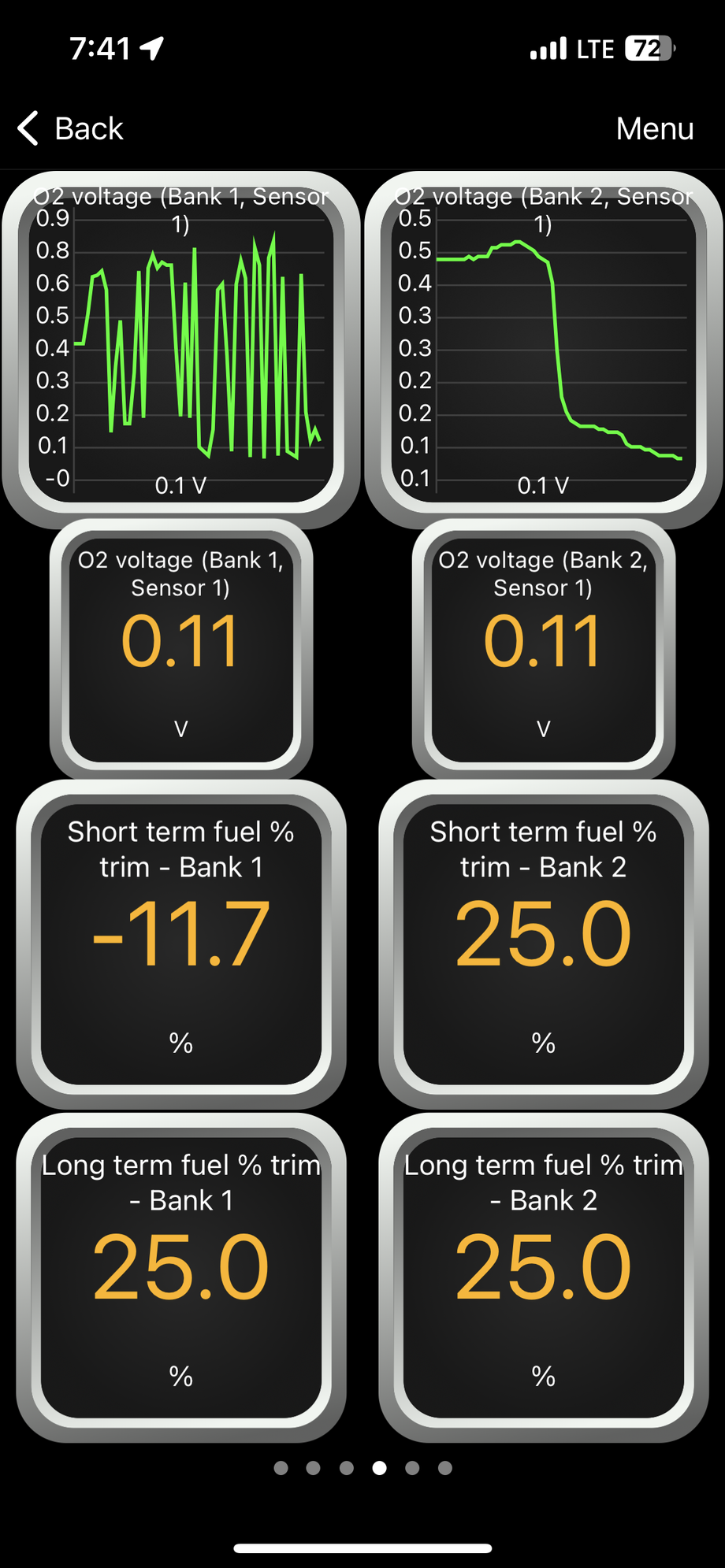

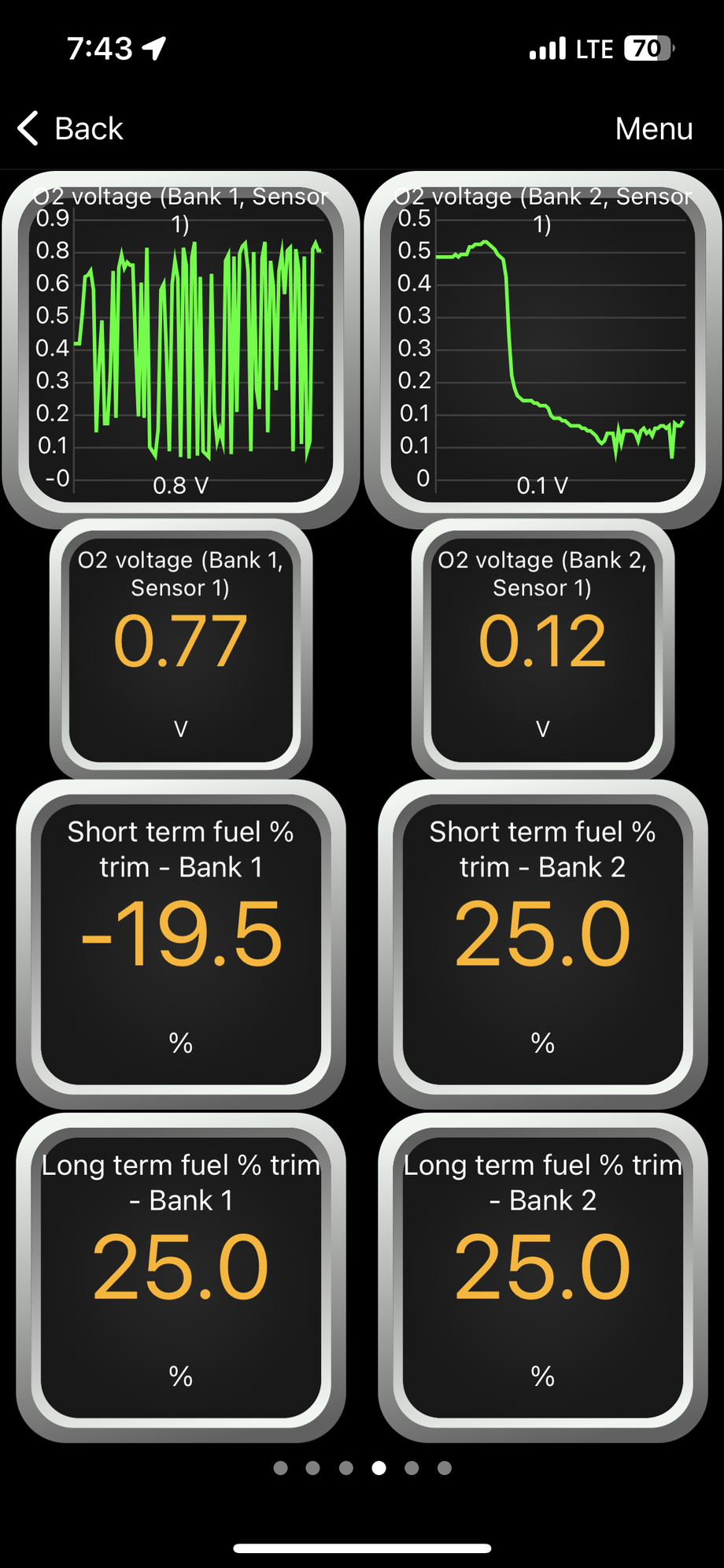

The LTFT both show 25 and don't fluctuate.
Maybe the wrong PIDs? I just grabbed the SAE default PIDs.
Some sample readings:

@Extinct , this set of readings is all after swapping the working sensor from bank B to bank A. The sensor was also reading correctly in bank B previously. As described in your scenario 1.
