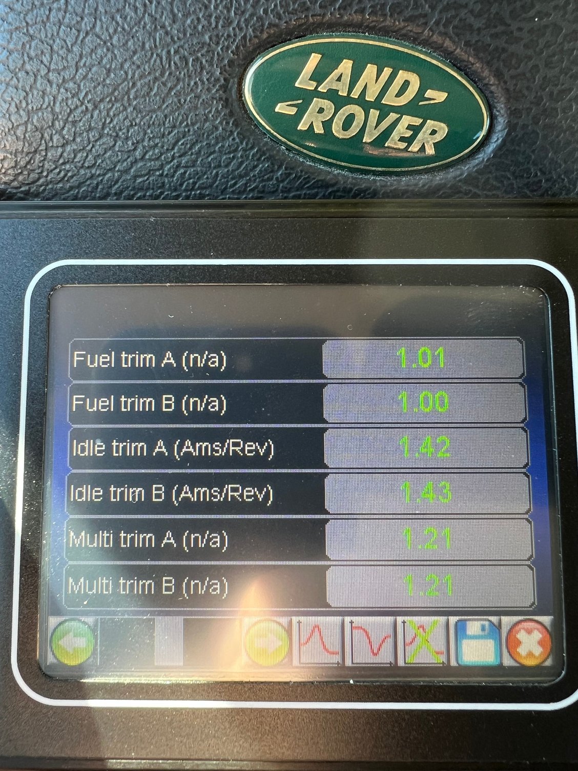

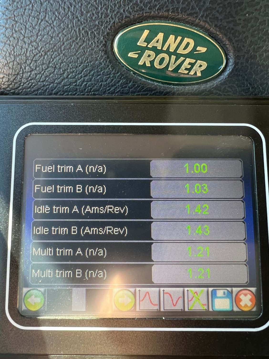

Old Oct 6, 2024 | 07:47 PM
  #34
cds72911's Avatar
Joined: Dec 2021
Posts: 89
Likes: 20
Here's a screen shot I took, for example:
Not sure if any of this is interesting?
