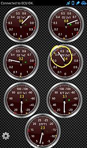

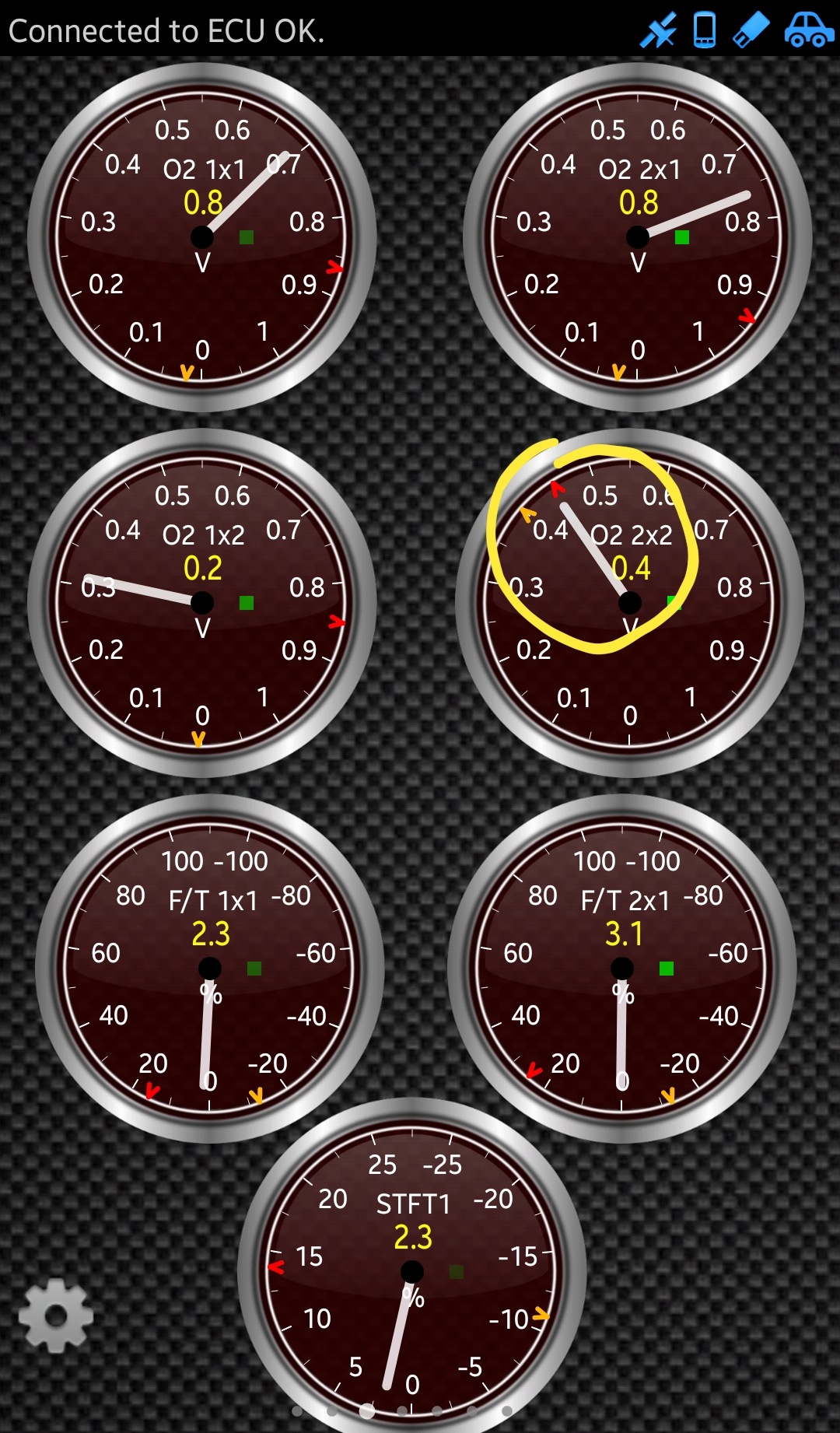

...went under my truck to try swapping the B2 sensors with no luck, I just couldn't reach comfortably enough to get a nice grip and unplug it ...damn, talk about being between a rock and a hard place. I'll lift my truck tomorrow and see if I can get a better reach.
I went for a 20 mile errand-run after the attempt and symptoms are the same, so thankfully me jingling the wires did not complicate things. See pic of Torque Lite readings.

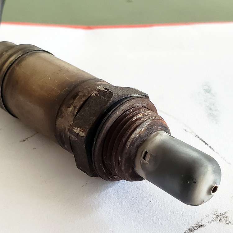

I did get a second sensor to replace driver's side, despite it seems to be working fine, but I believe it is recommended to replace them in pairs; and although this side's is much easier to access and replace, I was not able to make it turn after I few tries; besides, it was too hot out and since it was working, I decided to crawl out and confirm the first one solved my prob; so fire-up the tuck, gave it a few runs around the block, and indeed it solved the initial prob, so I'm happy so far. I cleared the faults, but will see after this week's commute. See pic of removed sensor attached.
