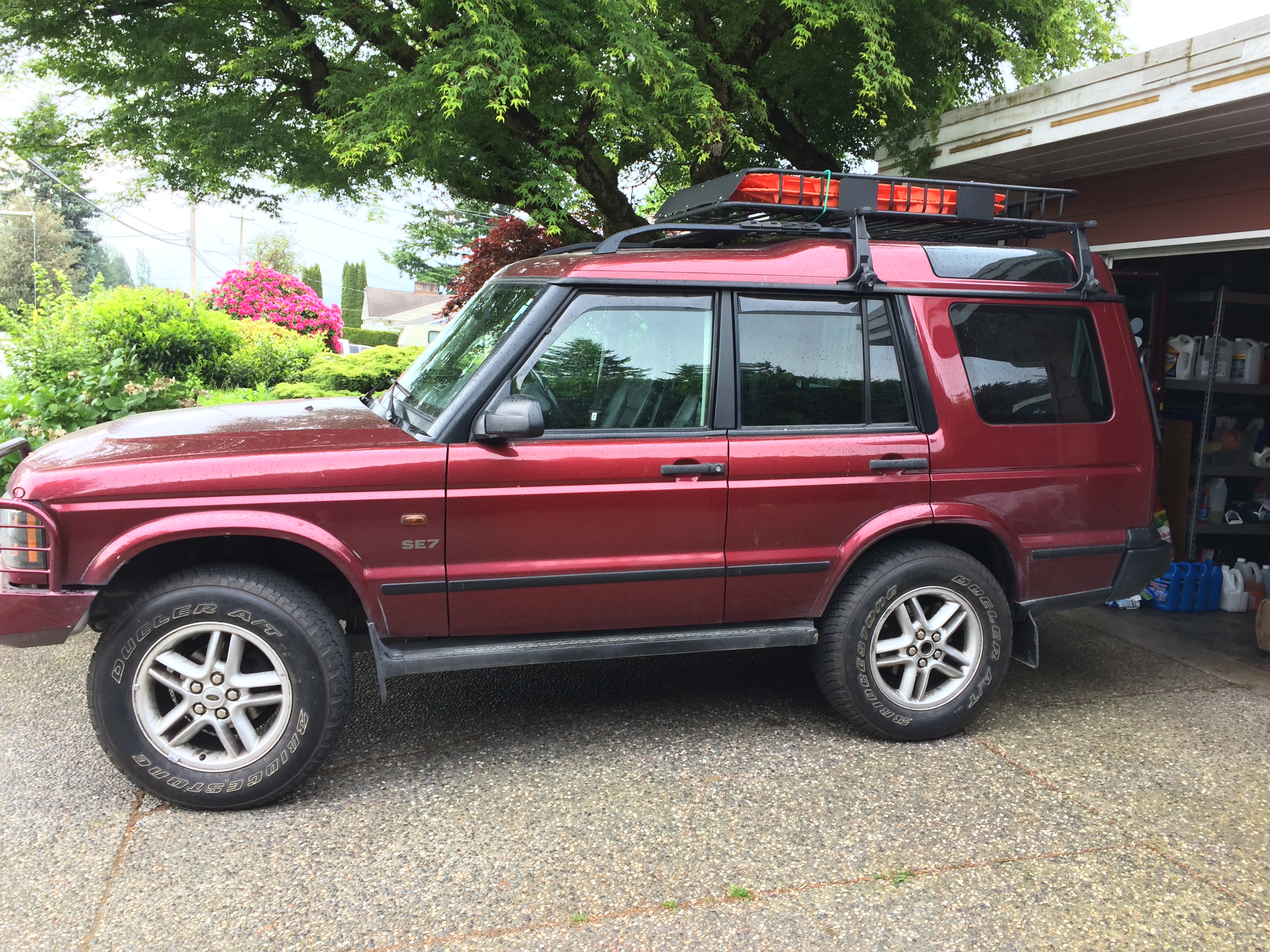

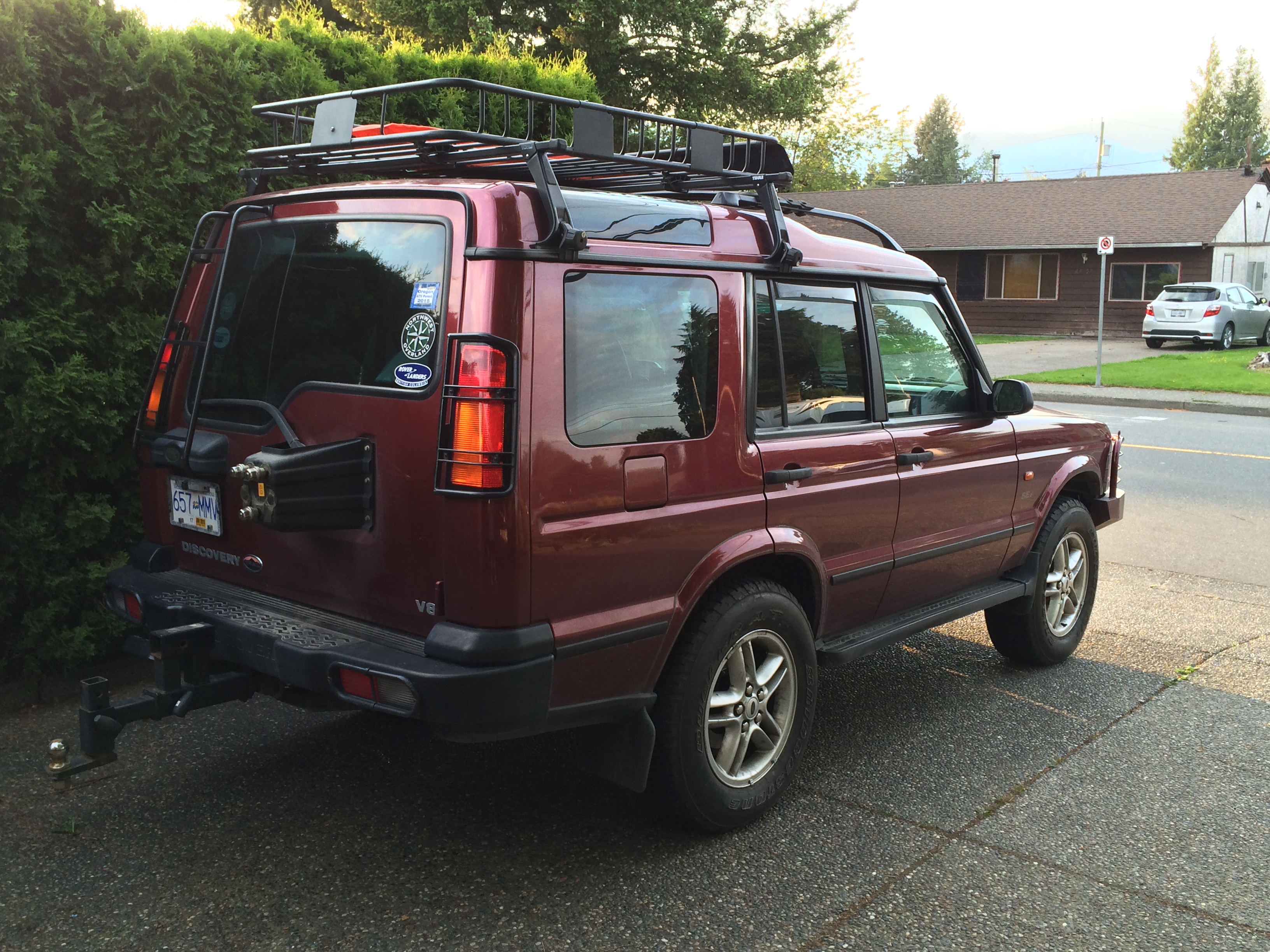

Jamieb,
You mentioned wanting to set the Disco up in the future for off-roading. Having CDL is the best bang for the buck together with getting the right tires for 4-wheeling.
The first 3 pics shows a set up with 255/70R18 tires (32.1" diameter / 10.2" width). No rubbing against the front mudflaps. However, I decided to replace them with a wider tires.
The last 3 pics shows 275/65R18 tires (32" / 10.9"). BFGoodrich TA KO2. I like the additional 1/2" width footprint for off-roading. I am to trim off an inside section of the front mudflap for turning clearance (see last pic).
Terra Firma offers medium-duty and heavy-duty springs. The Terra Firma site will show the weight capacity for the springs. Your choice will depend on the additional equipment which you intend to carry (e.g. winch bumper, roof rack, etc). I did a quick weight distribution calculation on the Disco with the added equipment. I ended up with medium duty front spring and heavy-duty rear springs.
I hope the info will provide you with some good reference points.
