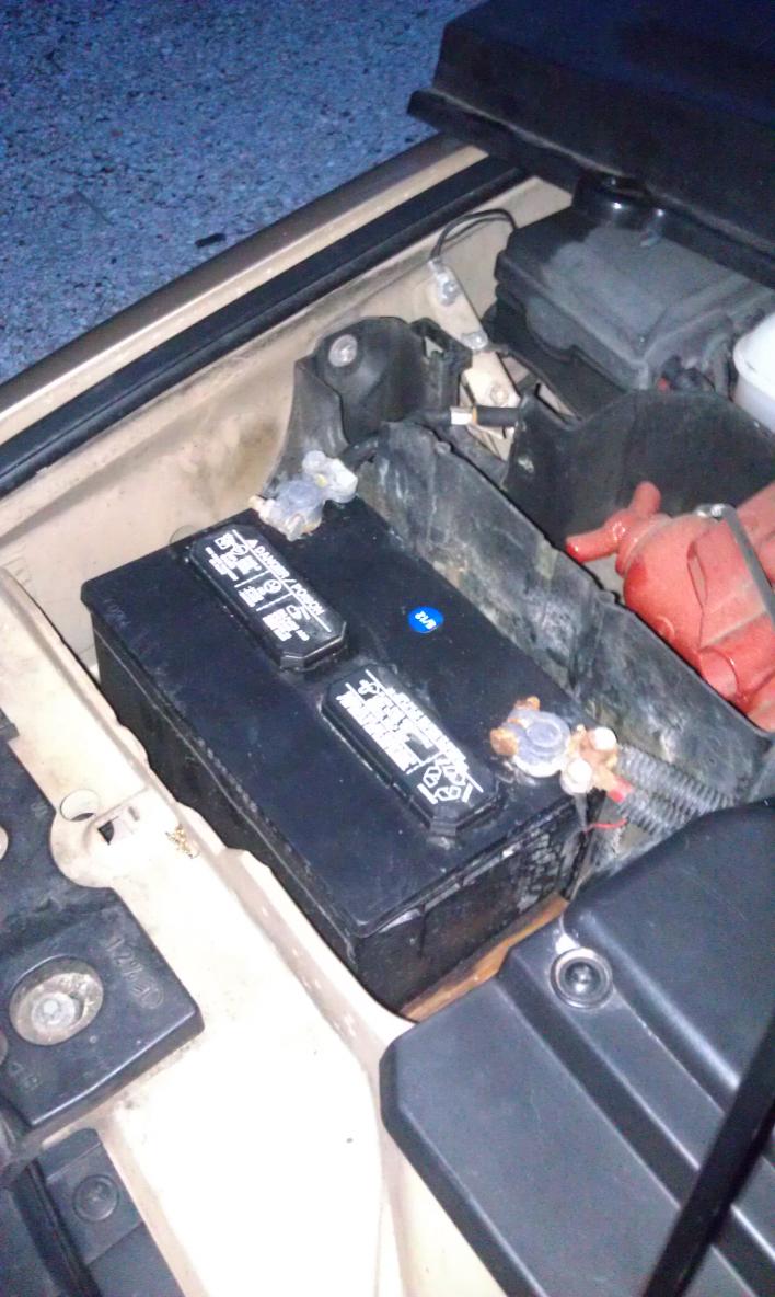

My '04 DII has been giving me trouble when starting and, although it always starts, I'm worried that it might not when I need it to. What would be the best or least faulty battery I could put in her? Look at the POS that's in there now bwahaha

A good, largest that will squeeze in there battery. While cold cranking amps are important, don't neglect reserve capacity, which is how long you can drive with alternator out. Alternators don't always fail 100%, sometimes they just drop in amps so that your battery dies when AC, lights, and wipers are on for about an hour.
There are plenty of things that will keep a Disco from starting besides the battery. One of them is poor quality terminal connections and the places they bond to the chassis for grounds.

The terminal connections could stand to be replaced but I keep them clean... Could you tell me where to check the chassis ground points?

Locate the negative lead. Follow it to bolts on frame or chassis.

You should be able to get a good battery with 36 month full replacement warranty and then prorated warranty after that for your needs. Diehard batteries are great and I like Interstate as well. The chain stores carry some with 36 month full replacement, Wal-mart, Autozone, Adv Auto, etc. I think size Group 31 or 34 is the largest that will fit in the battery box in a D2, but note that is not what most battery charts will call for, so know what you want when you go to buy.
