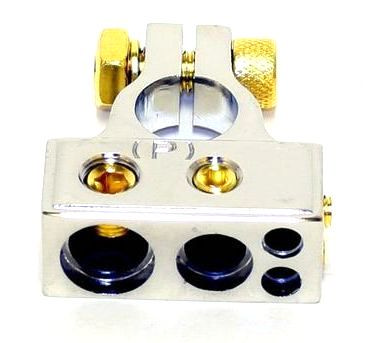

How about this?

Originally Posted by Charlie_V
Bam!
How about this?
Tommy Likey. looks expensive but looks good.

Just to update, problem fixed..
Spliced off the negative terminal, grabbed the nut and bolt for the positive side...
Bough a new terminal for $4.50, put onto the negative wire and attached..
10 minute job..
If you need to replace the positive terminal, I have heard Best Buy carries those in the stereo section.

Thanks for posting the fix and congrats for figuring it out.
I found this at Best Buy and then I suddenly found some on amazon.

I think this looks interesting
Battery Terminal Block - Positive - WiringProducts

Originally Posted by Joemamma1954
Spot on. Remove the old cable, unsolder the existing clamp and fit either a new conventional cable screw type clamp (as per photo) or cable soldered type. Job done in about an hour. Alternatively buy a new cable with a conventional clamp one end and suitable eye end the other. Most motor factors carry these clamps in stock.
