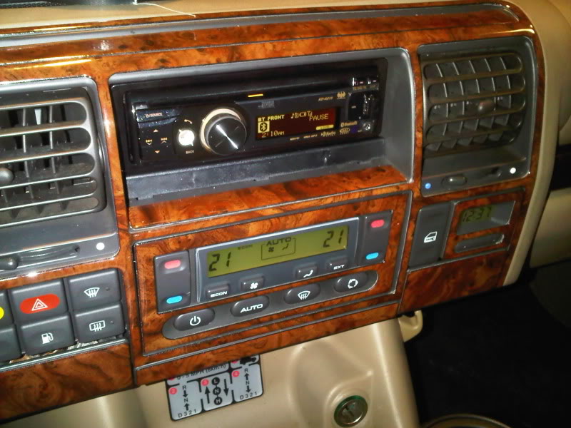

Finished product. Looks nice.

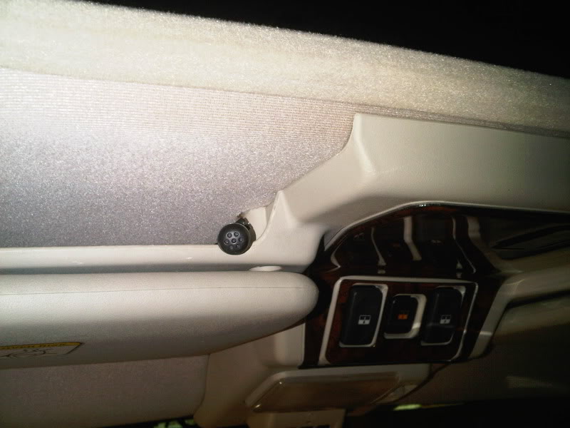

Direct wired and hidden mic for the phone. When you make/receive a call, the music is muted and the conversation is played through the speakers with adjustable volume. Crystal clear sound and great on the other end too. Call ID is also displayed right on the radio, as is battery life and signal. Your phone could stay totally out of sight or charging and no looking down!

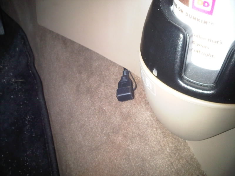

Wired USB for the iPod (with full iPod/iPhone control and charging). This is where I will connect the iPod cable, and hide the cable under the console and run it into the center storage so it is out of sight totally. When hooked up, the iPod is totally controlled through the stereo if you want so you don't have to have it out at all. Plus, it charges!

Nicely done. Having BT would be a real bonus for me...
Just to take this one step further, how is the remote attached to the steering wheel? Over the existing controls, or did you remove the stock buttons and mount this remote in their place?
It looks like a nice option and a good size for the remote. If my stock head unit dies, I'll definitely consider this as an alternative.
