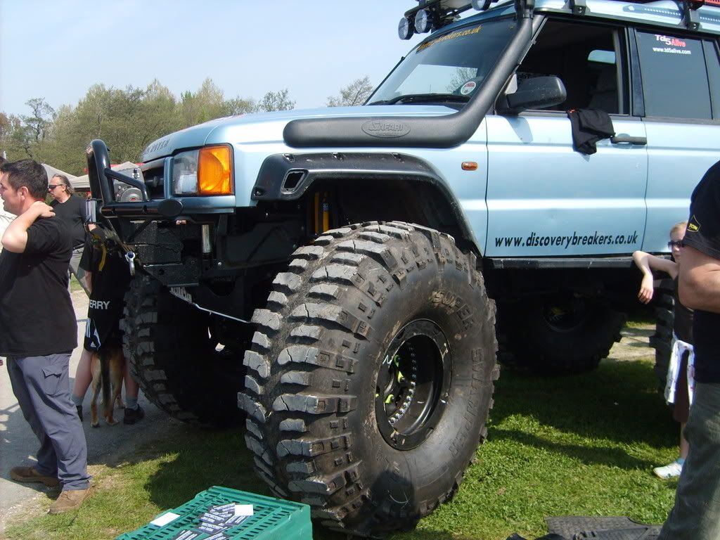

This is one big one.
Looks big to me. No need to worry if your neighbor blocking your driveway. LOL
What
What what gets me it the jeep that fender flares

Now, that looks like it would be a blast!
Brian.
