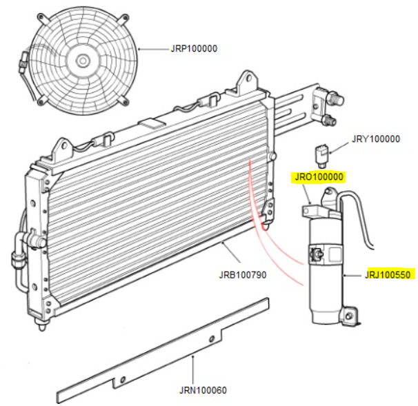

So in removing my condenser, a bolt was frozen in part of the receover drier and sheared off. I can't find it listed anywhere or mentioned anywhere .
Can anyone ID a part number or even name? Where to get one?
Thanks

This piece is the receiver drier, it is not sold with it. I'm happy to buy one, I just need to know what it is!
Yes, zuke is right you will still need a new receiver drier (JRJ100550) and o rings.
The plate is sold separate, but that's if you can find one for a good price. I think I would work on extracting the broken bolt.
The part you are looking for is the ADAPTOR Plate/Base #: JRO100000

Llamasayswhat's Avatar
Joined: Nov 2017
Posts: 450
Likes: 81
From: Kailua Kona, HI
Excellent! thank you!
BTW, what parts catalog are you using?
