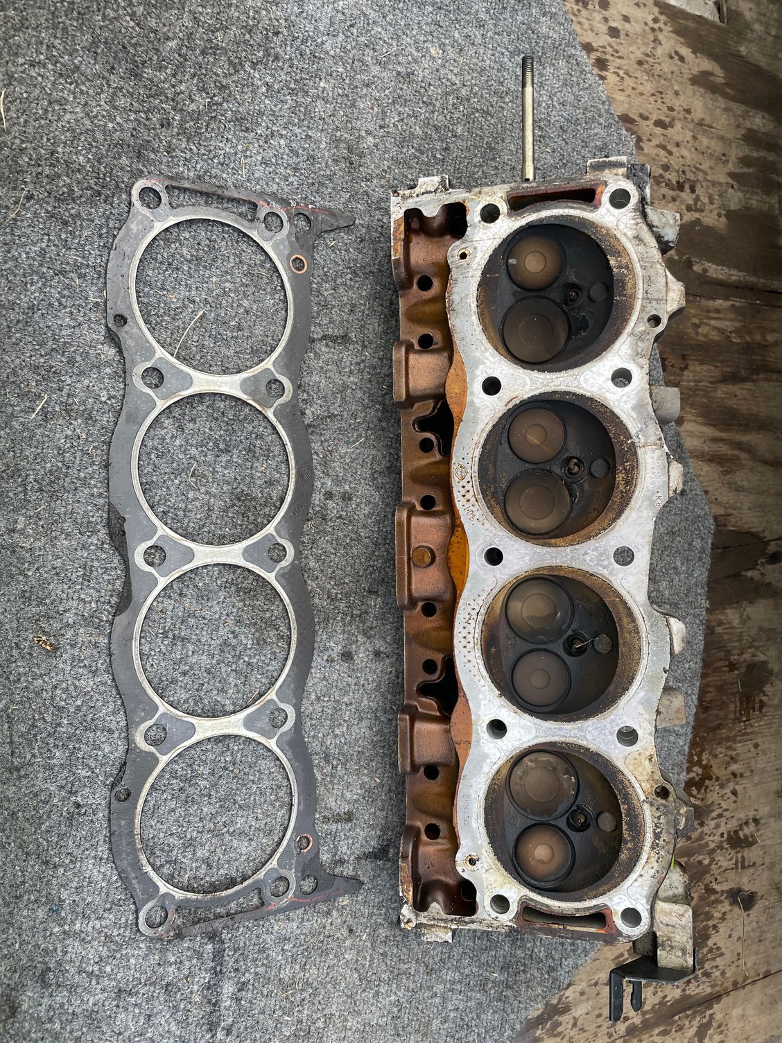

Update: I got the driver's side head gasket off... two back bolts remain on the passenger side...

@Extinct Thank you, followed your advice to a T and I got them all off today. Would it be okay for me to send you a PM?
